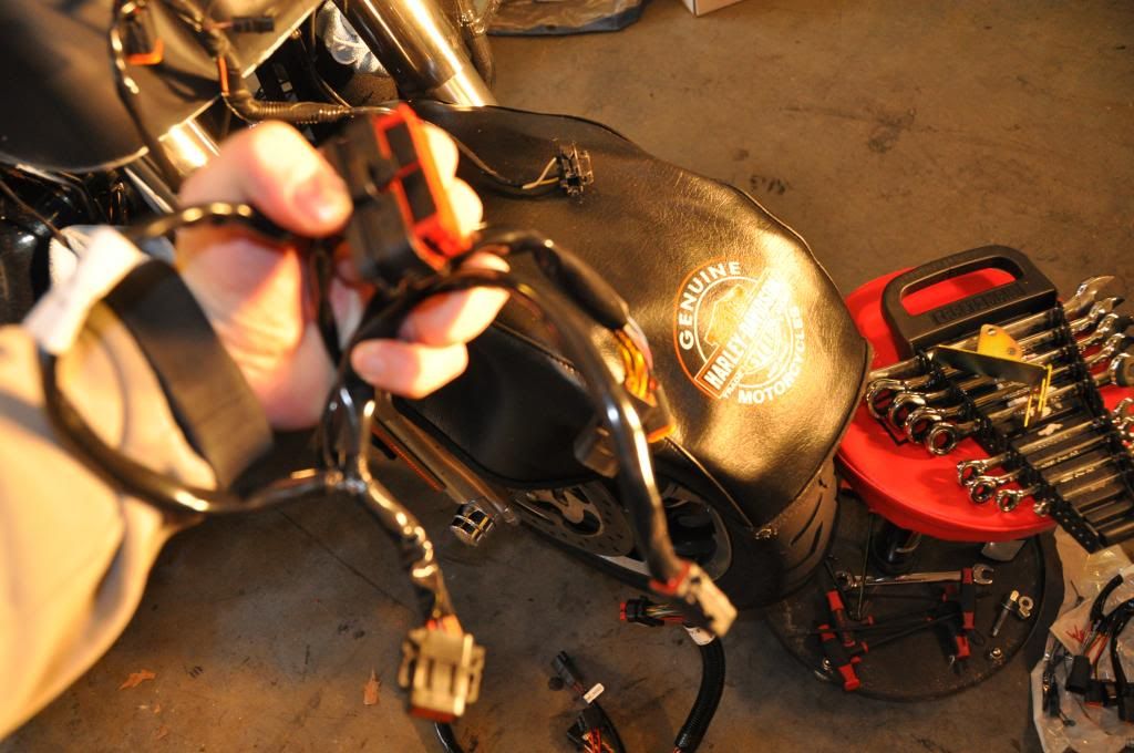

The saga continues... I put a detachable king tour-pak on my 09 RG, and bought a NUOH, 70169-06, so all the rear swithes and what not will work. Unfortunately, it didn't come with instructions, and there are none on the MOCO website. Does anyone know where I can get some instructions or has any one done this before?

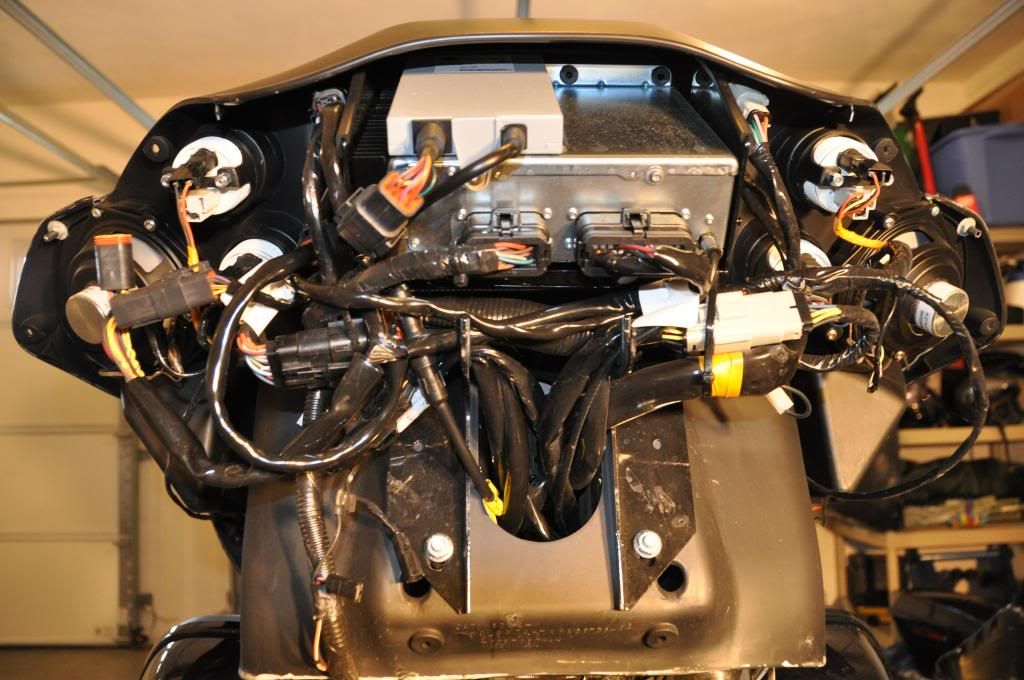

I know how to install the nUOH, but I didn't install the tour pack so the CB, Rear Speakers, and such connectors were just bundled and stuffed into the fairing.
Here is how my 2012 looked, with the iPod interface installed:
The non-Ultra Overlay Harness completely replaced the wire bundle on the right side of the radio, as looking at it from the front.
Un-plug all the connectors and remove the harness:
Then plug in the non-Ultra Overlay Harness and plug the connectors in. I also installed the navigation interface harness, so I had to plug some additional pins into the connector that plugs into the radio.
