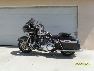

I moved both of my antennas inside the fairing when I installed the Detachable brackets.
I bought a cheapy AM/FM Hidden Antenna
off eBay for less than $20 with Free shipping.
I used the J&M Hidden CB Antenna for the CB.
CB antenna is lower left
I just rolled the leads going to the Tour Pak
up and tied it under the side covers.
Makes taking the Tour Pak off easier.
