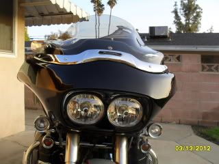

I had no problem installing my trim kit. I had the stock windshield when i first got the kit. I just followed the instructions. I had to adjust the off set screw holes a couple of times. But when they were set correctly, the holes lined up and the screws went in and tightened up correctly.
I changed my windshield twice. I went from the stock shield to a Klock Werks 16" and then to the Klock Werks 12" windshield. Each time I just made sure the off set screw mounts were in the same position and the trim went back in place easily. I even had to replace the outer fairing. Each time I removed the trim, I just made sure the mounts were in the same position. The only problem I found was the rubber under the chrome. It was old and I had to make sure I was careful with it. I never had the trim damage the paint. I just made sure there was rubber under the trim and not bunched up.
Trim with the stock windshield
Trim with new fairing and 12" Klock Werks Windshield.

Is that KW windshield clear or light tint?
