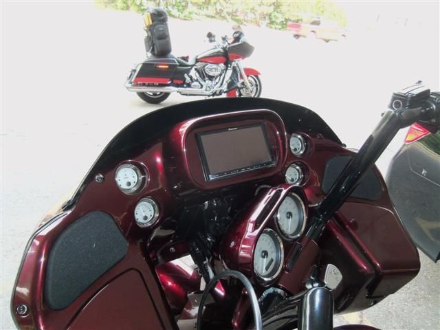

Pretty sure that fairing that h-donut posted, is an audiowerks custom cycles inner fairing.
They do an exchange for your stock.. $600 for the double din, and $600 core charge. They look great IMO.

They do good work. I like that they use an existing H-D inner fairing to work from. That way you have all the right holes, glove boxes, and mounts. Most times when people mold off and reproduce in fiberglass things don't come out right.
