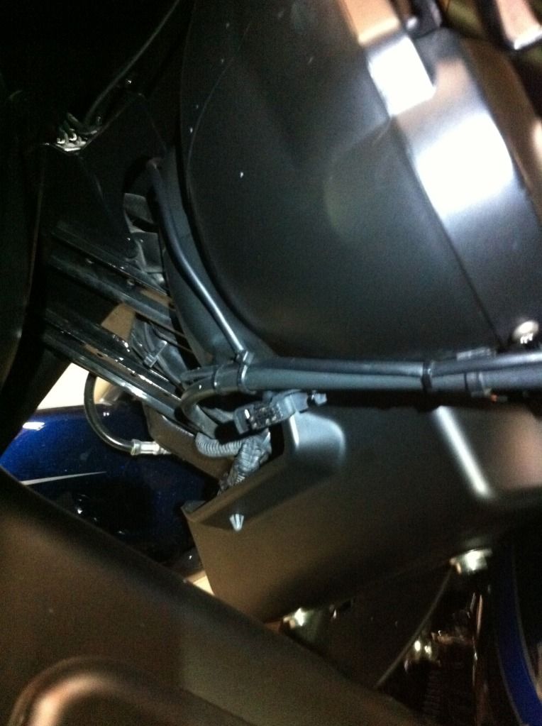

You will be done in no time
Here is a pic of how my cable rests when I leave it in place with the PV off. Not all that noticeable.
