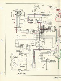

1980 FLT has crushed, frayed and intermittent wiring problems.. I am hoping to find a wiring diagram for this machine. Specifically, ignition and lighting. Is this info available and downloadable? Any assistance in steering me in the right direction for diagrams would be appreciated and whatever info on bike is required I can provide. TKS in advance, bsamot69 in SoCal

Here goes the 80-81
