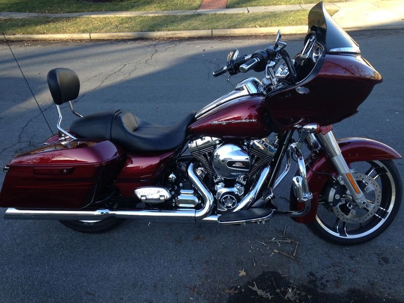

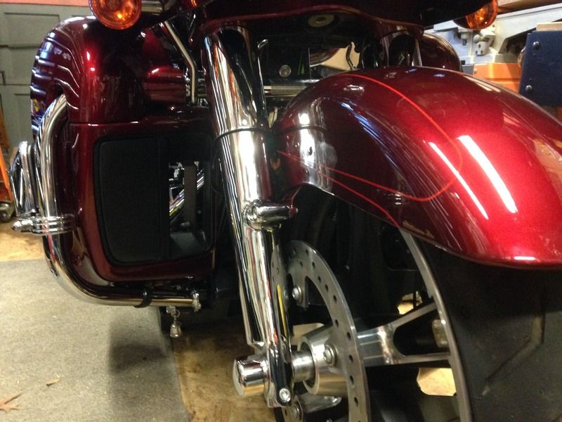

Here are a few photos:
Added some chrome cowbells, lower sliders, axle caps, and color matched lower fairings.
Added Polk MM651 speakers to the lower fairings and upper fairing. I need to complete to the wiring and the install of the Soundstream amp.
And added some Factory 47, 12" chrome Malo bars.
I am hoping to ride in to work on Wednesday. Last I checked the weather predictors were calling for mid-70's.
