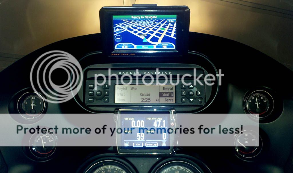

The gauges are why I mounted my PV. I change them from time to time. I moved my 660 up on top of the dash to make room. The GPS is actually readable in all conditions up there. I need to change the angle of the PV so it more directly faces me on the Iron Aces mount.

Can you show us how you mounted the GPS? I like that set up!

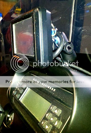

Short Ram mount with 2 square GPS mounting plates, bolted through the dash. I used an aluminum plate under the dash for stiffness. Cut a small notch where the inner and outer fairings meet under the windshield to run the cable.
I can read the GPS no matter where the sun is. If you notice, the GPS is angled slightly down. This eliminates glare pretty much completely. I need to angle the PV down a little. It's sometimes hard to see. Just haven't figured out a clean way to do that yet.

Thanks for that! sorry To hijack the thread...
