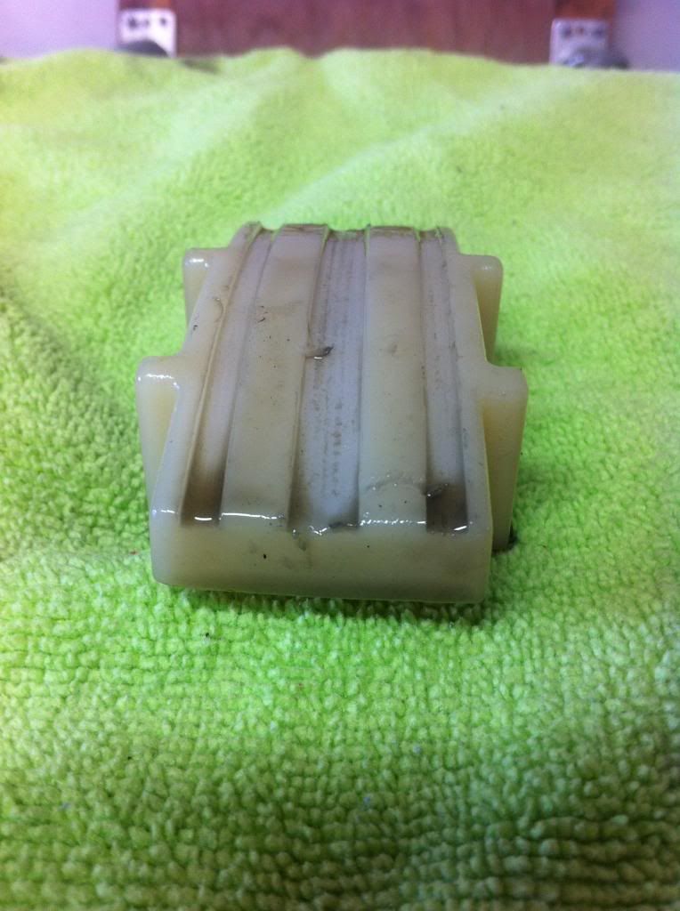

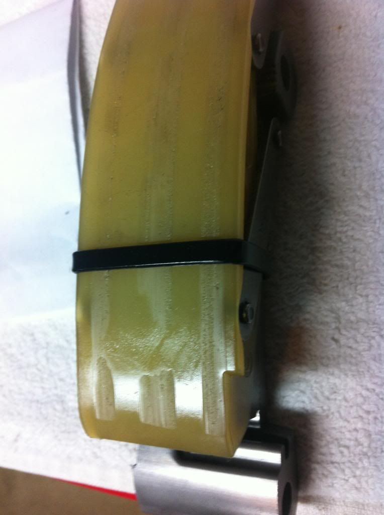

I pulled the primary cover and removed the Hayden Tensioner and found what I would consider excessive amount of wear in the shoe especially when you compare it to the original HD tensioner shoe that had almost 30K on it.
Here is the Hayden with approx. 2500 miles
Here is the stock unit with almost 30K
Which one is to tight??
I contacted Hayden and sent them the pictures, explained once again my concerns about the chain now being to tight using their product and asked for a refund of my purchase price or at the very least replacement springs and a new shoe. Below is the reply I received form Hayden after making numerous attempts.

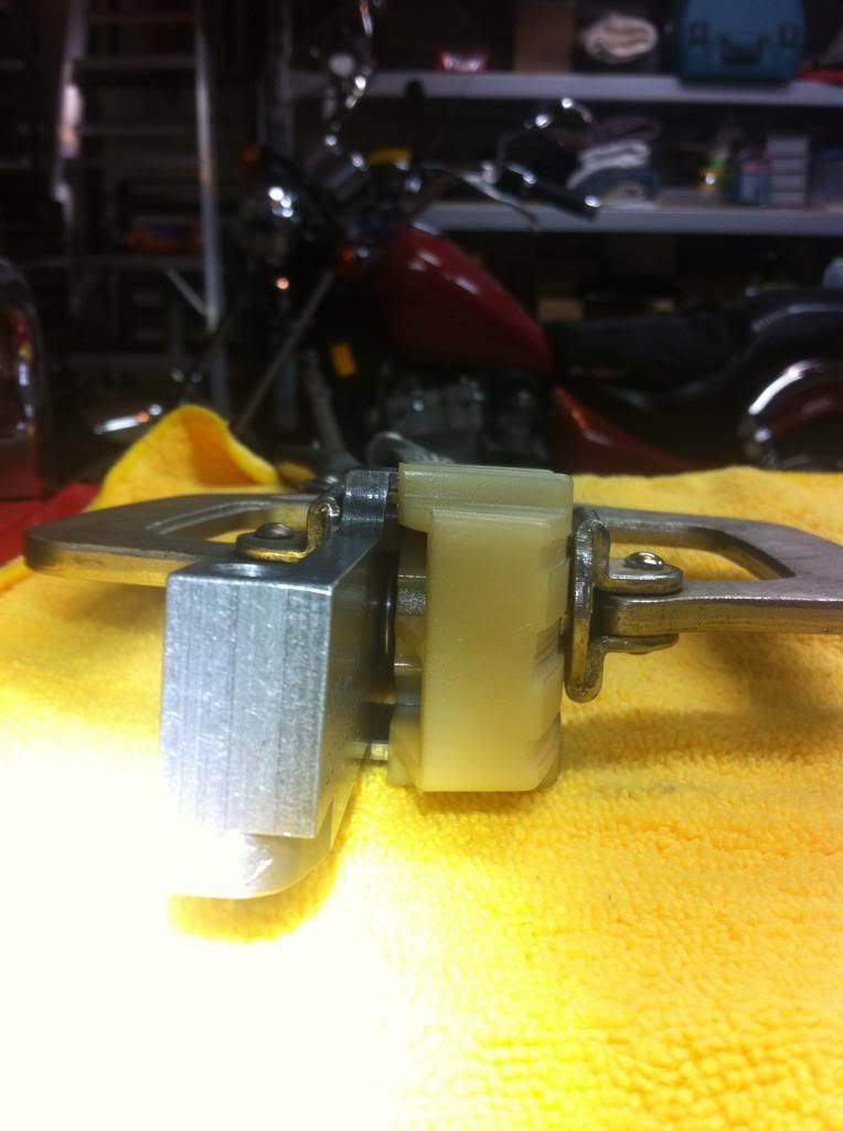

For grins I put only the outer spring back in as suggested and then bottomed out the shoe using vise grips. As you can see in the pictures the spring bottoms out before the shoe even hits the plate leaving a gap of slightly less than 1/8". That means that with the original 1/4" gap that Hayden states is normal and fine there is only about and 1/8" of movement before the spring bottoms out and there is absolutely ZERO play in the primary chain. That can't work. What happens when the primary heats up and things expand?
Even using just the one spring as now suggested is not going to fix the issue.
