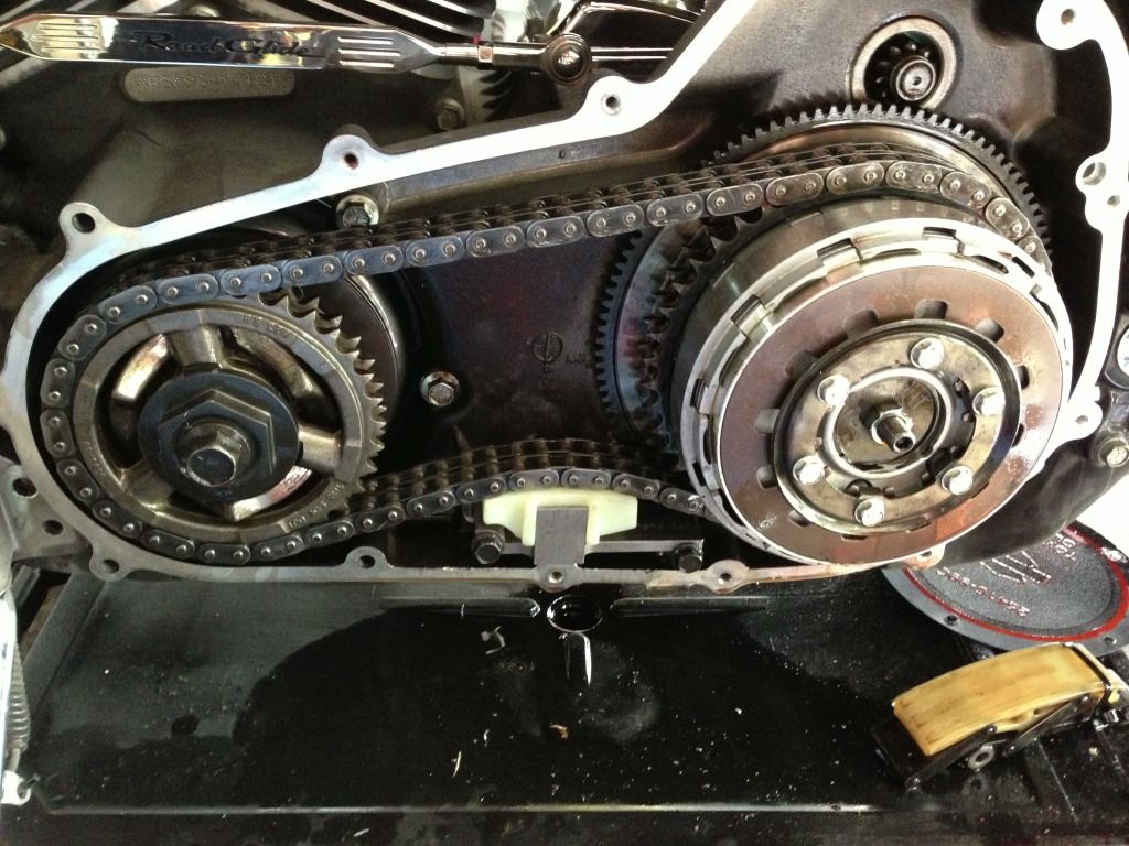

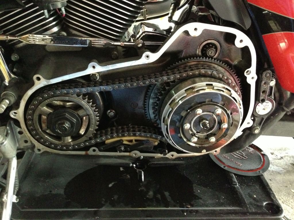

How about 50,000 miles, or more? I've had one on mine for quite a while. Things are going great. The stock Harley tensioner is a cheap shit piece of crap. It only allows for ratchet adjustments, and only tighter at that.
Here is my before...
Here is my after...
Notice the difference in the slack at the top. The Harley POS can only make things tighter, until it gets too tight. Then it can ruin bearings. The Hayden is spring tensioned, and can allow for less slack in the chain because the springs manage the slack. It also makes the primary quieter, with no chain slapping around inside.

OBTW, that whine is the chain making a groove in the shoe. Nothing to worry about. Once it seats, it is good.
