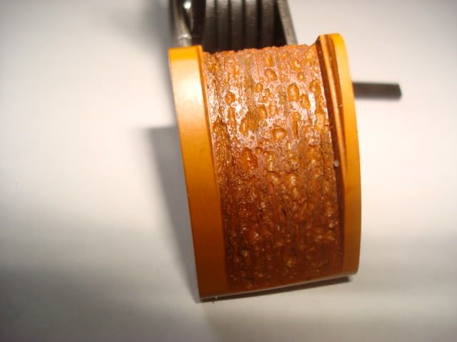

Ok you motor heads. Haven't seen much talk here on tensioner wear (gawd knows its all over the web elswhere). Here's what mine look like at 70,000km (43,000 miles). I think I'm good another season easy. I know the inside wears more but I have an ESP on my '05 so I'll ride out the rest of that hopefully before I change them. I don't think its a big deal yet.
Here's what mine look like.....what do you think? I would appreciate any and all opinions, stories and experiences.

You've got the ESP wich is cool, but what about in the middle of a road trip.... Thats how things go for me anyways
That would bug me because in my limited experience once they start to pit like that, things start to happen quickly. The shot is my front after trying to get one more season(my back was better??) Too close for me and your circulating all that crap....

If my shoes looked anything like yours i'd be putting new ones in for sure. The service manual page you posted says if the shoes are equal to greater than half the thickness of the shoe then replace. I'm not half yet but good point about failures on the road.
Mike
I'd love to go to gear drive but my esp is good until 2012 so if i have to buy a new set of shoes before then i will instead of gear cams.(cheaper) Once the extended service plan expires I'll look at other options.
Doug
The way i see it i'll be good for a few more thousand clicks before i get 50%. I'll watch my milage and pull the cam chest open again to inspect. It's not too difficult now that i've done it once. The hard part is reinstalling the exhaust pipes.
Thanks guys for the input. Have you done your shoes yet or checked them Doug,Mike? I'm curious to see more pics.
