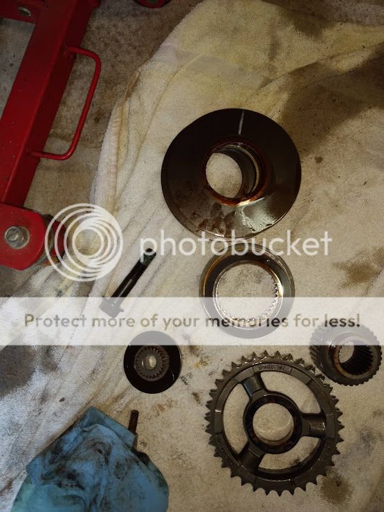

Lookee here

Originally Posted by JacktheBagger View Post
Lookee here
Where did all those metal shavings come from ?

post #9 of 24 (permalink) Old 03-10-2019, 08:35 AM Thread Starter
JacktheBagger's Avatar
Location: Bama
Posts: 9,012
dont know , maybe magnets , gonna pull the stator and rotor this afternoon if the weather don't turn to anymore crap than it already is ..
