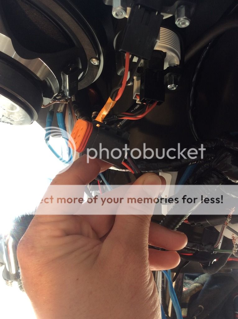

Well just tore it apart again to check my settings and connections. I had my turn on set to remote and x-over to hp. I did try flat but it doesn't change anything. Really lost on what to try next. I do have hd daymaker lights and read somewhere on here that they can cause issues. Not sure if they came from the factory with these or not as I'm the second owner. But I did notice that there are a couple of wires looks like a power and ground that aren't being used in the bunch that goes to the lights. There is also another plug that isn't being used that has 4 wires on it. Not sure what they are for but I'll try to add a picture maybe is part of my problem? I tried running a ground wire from the unused black wire to the negative k. The terminal thinking maybe that needed to be grounded but also didn't change anything.
Hoping someone can chime in with some more ideas I hate the thought of having to bring it to the dealer and trying to see if they can figure it out. But now I'm thinking its that or just run the speakers without the amp.
