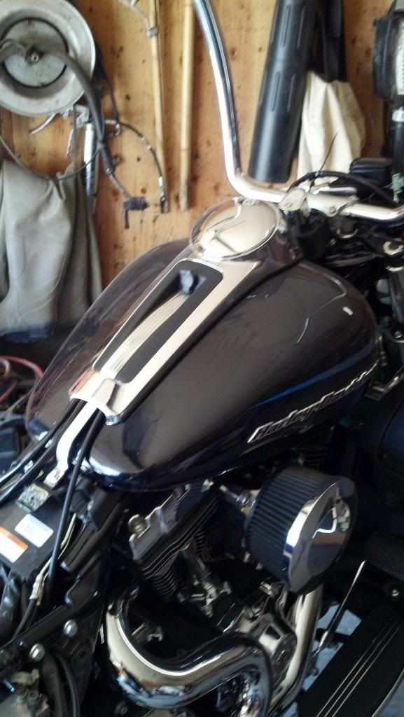

Now onto the tank, I bought a Bagger Nation dash from a forum member and test fitted before paint.
Before:
After:
As she sits now. I got the front end taken apart last weekend for powdercoat and Monotube install, also got the bars wired and tank removed for more wiring. I travel throughout the week so I only have weekends to make this happen, it's time consuming!
