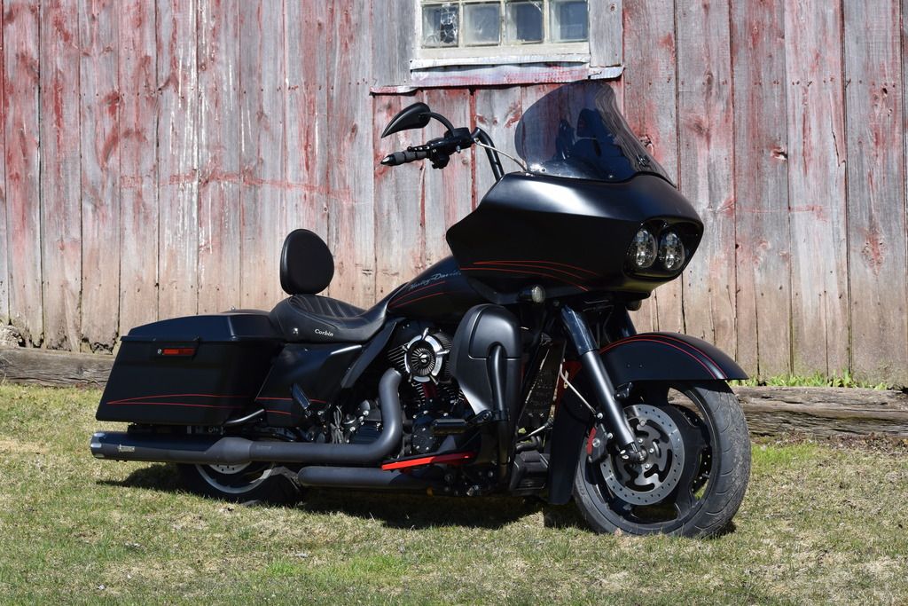

I took my bike to my local HD dealer to have several motor parts coated on my 2012 RG, this was in 2016. Everything chrome on the motor was coated, either gloss black, flat black or satin red. It looked outstanding. HOWEVER, between the powder coater and the dealer, someone didn't do their job. The pushrod tubes were not plugged or capped and got powder coating on the inside, other parts didn't have the blasting media cleaned out well enough and that glass went through my motor. Needless to say, the motor was junk, it wasn't running well on the way out, but from Sturgis to Green Bay, I went through 8 qts of oil.
The conversation started with the dealer, explaining what had happened and the said and I quote, "we've eaten the cost of too many of these lately, I'm not doing it on this one, plus that's the chance you take when you have motor parts coted". The powder coater had a similar story, neither wanted to accept responsibility and blamed the other. My reply to the dealership owner was this, "the one thing I know is that I paid the you the money to do this job and do it correctly. Weather it's the responsibility of the powder coater or yourself I don't know and quite frankly don't care, I just know it's not MY fault that my bike is in the condition it is". A week later I got a call from the dealer telling me I was correct and no matter who's blame it was, he was going to make it right. I had the option to get a new motor in my 2012, or trade that bike in and get a brand new 2018 for $8500. This was not a no brainer for me as I had my old bike right where I wanted it sans the motor, but in the end, I felt there were too many upgraded items on the 18 to not go new.
Careful with your powder coater!
