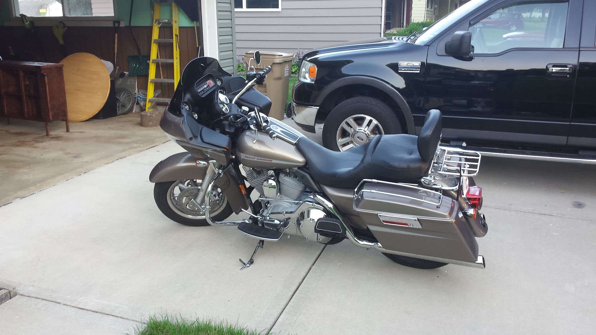

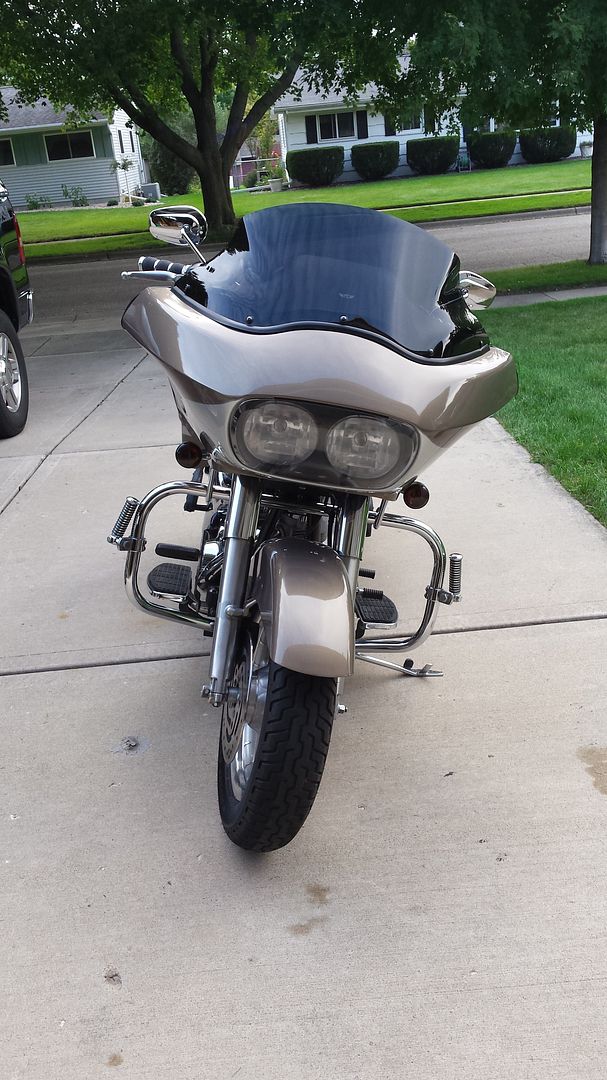

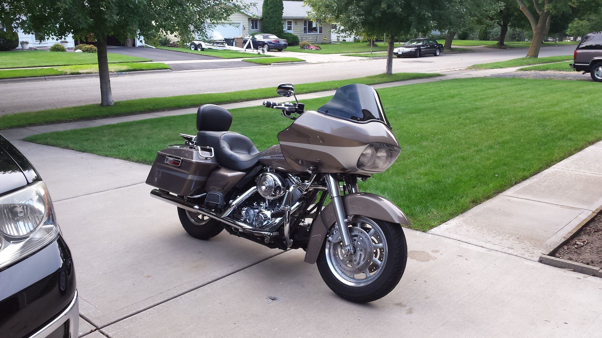

Finally bought my Harley this last June of 2015, A 2004 Road Glide with 15,000 original miles. Ive wanted a Bagger forever and sick of seeing the same old Street Glide or Electra. I found the bike online at a local dealer, went to look at it and it was clean. The low miles and it didn't even look like anyone's rode it. They wouldn't budge on price so I walked away. Few weeks later the bike was still there so I emailed the same sales guys and they finally came around. Took it for a test drive and I was hooked. I really wanted something I wouldn't see at every bike night and the fact its a road glide and the color was it.
This was the day I brought her home.
First thing was to get rid of the yellow turn signals and stock tail light,
