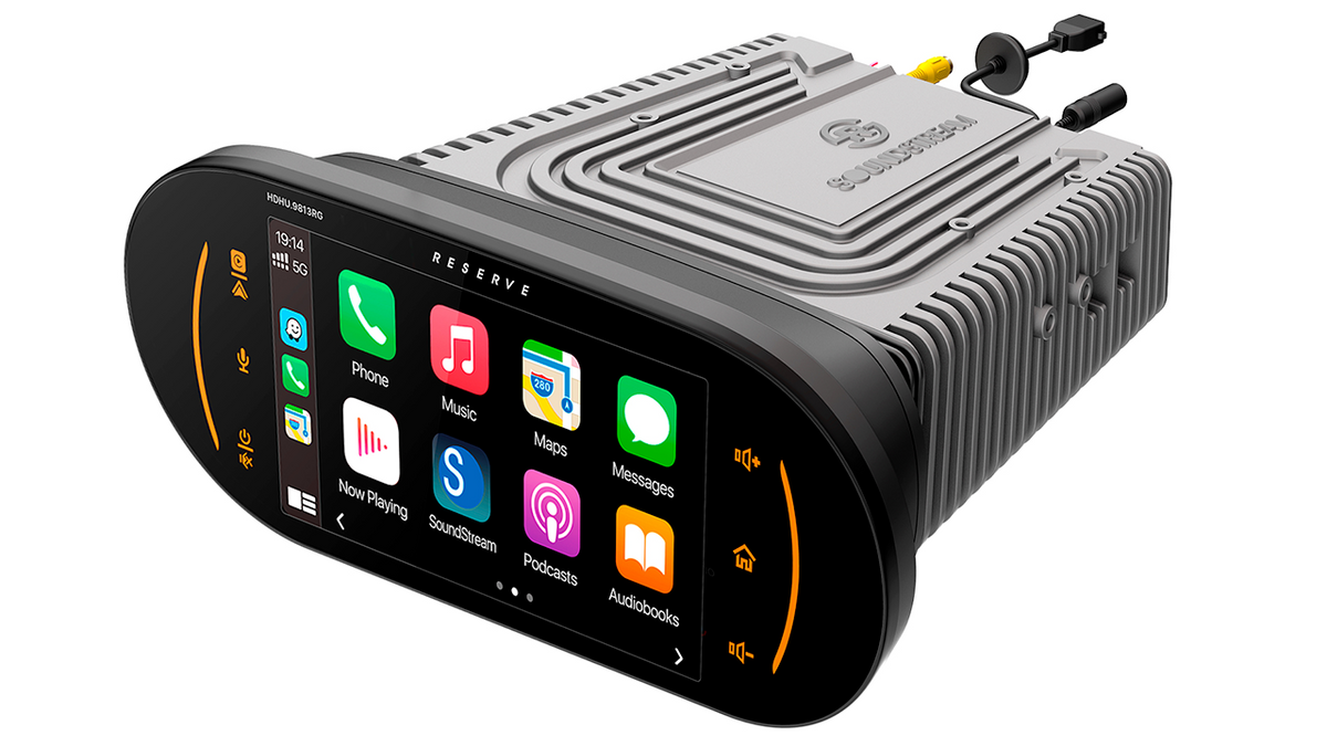

Its pricey, but this head unit is coming, with carplay, I have the HDHU14+

That soundstream looks the tits
JtB
Yeah, my brain has been digesting it for the last month in an attempt to justify spending $1000 on something I’m able to accomplish currently with my phone and a handlebar mount. Especially since I already spent $200 adding wireless Bluetooth to my HK head unit a couple months back……. But fuck, it sure would be sweet……
2011 Road Glide Ultra
253 Posts
For real. It's 2x+ the price of all the other head units out there.
· Premium Member
Bastardized 2011 FLTRU
958 Posts
Yes, it’s stupid. But Soundstream basically has the market cornered on a head unit with these features so you either pay it or you don’t. I definitely can’t swing it now right before the holidays, but knowing me I’ll probably pull the trigger come spring….
I had seen the Soundstream unit before, but I'd be curious to hear about your experiences, even though I realize your model is slightly different and for a newer bike. How do you like it?
