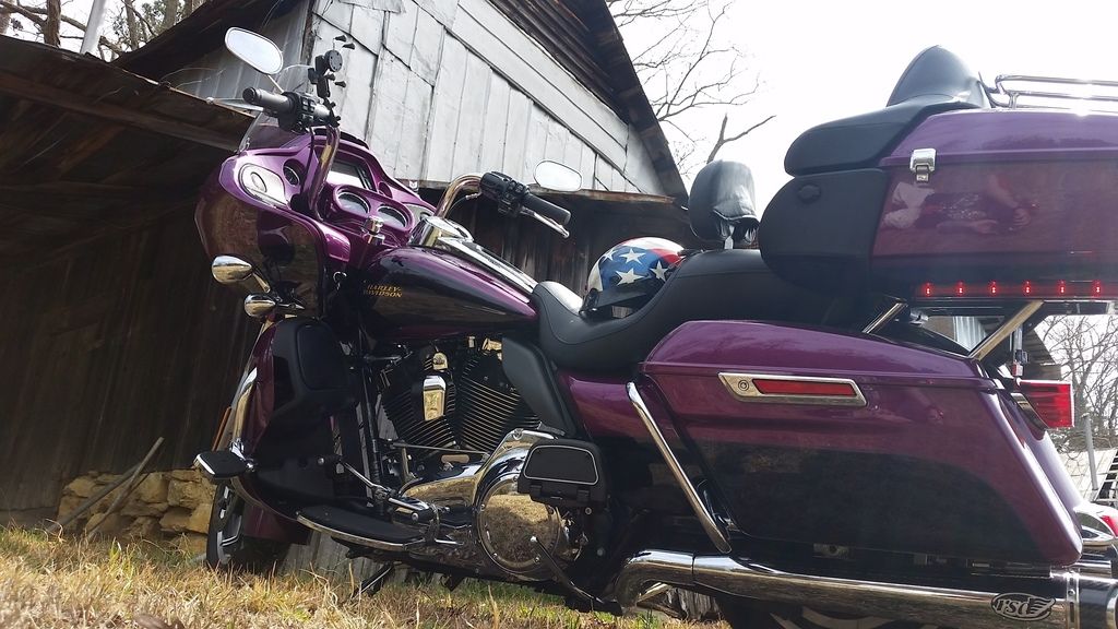

Well I've got success on the light mounted on the forks. I finally have it high enough where it doesn't hit the fender. Here's some pics.
This is a shot of just the new Rigid 6" off road light.
I'm using one of the switches on the gauge cluster and wired to the relay that came with the switches. On the bracket I'm working on a final now. I made a back-up plate under the plastic piece to reinforce it. No contact with fender during bumps of full lock to lock travel.

Shouldn't have any issues with people saying they didn't see you coming. Still a bit of a dead spot just to the outside of the fork area close to the bike. I think you can add some caliper mounted lights to clear that up.:grin:
Hey Steve, do you have parts numbers for the switches and relay for the new RGS? That would help with some of us adding driving lights to the 15/16 bikes.

Sorry been out on vacation. I haven't found the part numbers yet. I even asked while in Daytona. Seems there not an easy number to get. I'll get with my guy tomorrow or go through my receipts to find out for you what the switch numbers are.
