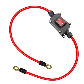

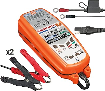

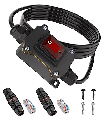

That said, how do I deal with it moving forward? Obvious answer is a Battery Tender (no shit). The issue I have, is that the garage I store it in is not mine. There is no electric in it and I do not think the owner would be keen on me putting a solar panel on it and running wires etc. TONS of people must run into this due to storing bikes in SHEDS with no electric and have solutions, right? Maybe. But I am having a hell of a time.... It took me a LONG time, but I found a product (link below) that can charge the bike battery from a truck/car battery. The only issue is that the charge will be 2A, and these Skyline equipped bikes should have 5A. 2A has to be better than 0A though, right? I could then easily carry the truck battery by the handle into my place right nextdoor and put it on a charger while I am at work all day -maybe once a month or every few weeks as needed. I also found a battery cutoff switch (link below) that looks like it would work to help. I would like to try the cutoff switch first, but I am not sure where I would mount it. I am also not super excited about monkeying around in the battery box etc on a brand new bike. For the time being, I will try to RIDE IT REGULARLY to keep it charged. This will be an ongoing thing. I know there are other threads about this, but I hope this one helps as well.
