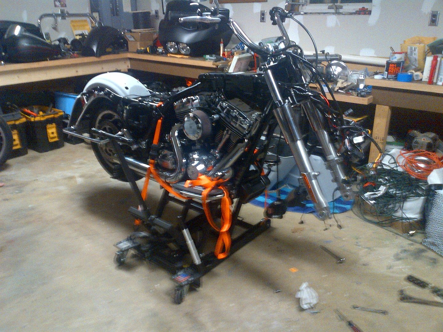

I’ve been hoarding all my parts for the winter to tear it all down, but the weather was crappy and I was board, so what the hell, might as well get on it now. I’m going to spray bomb the body parts until it goes out for paint. This is what I’ve done so far and what is getting done this week.
Mods:
Sony DSXMS60 Receiver (done)
Hawg Wired 6 Pack (done)
Pioneer 6.5 in inner faring (done)
HID Lights (done)
Fuel Moto 107” Kit w/ Level B heads/ Woods 888 cam (done)
Jackpot 2-1-2 pipes with CFR’s (done)
Power Vision (done)
Ridewright Fat 50 wheels, Black /Red/Chrome 23” up front 18” rear
Pickard USA bolt on trees
Ness Smooth Hot Legs black
HHI 13” Rotor and Caliper
Fat Katz Philly front fender
Bucky Bars 12” Malo 2.0
PM Contour Grips and Levers
Arnott Aldan rear air ride
Top Shop New Style Bags and Minster Fender
Plasma rod 8” 3 way (temp until I decide on lights to cut in)
Yaffe tank w/ DG seat

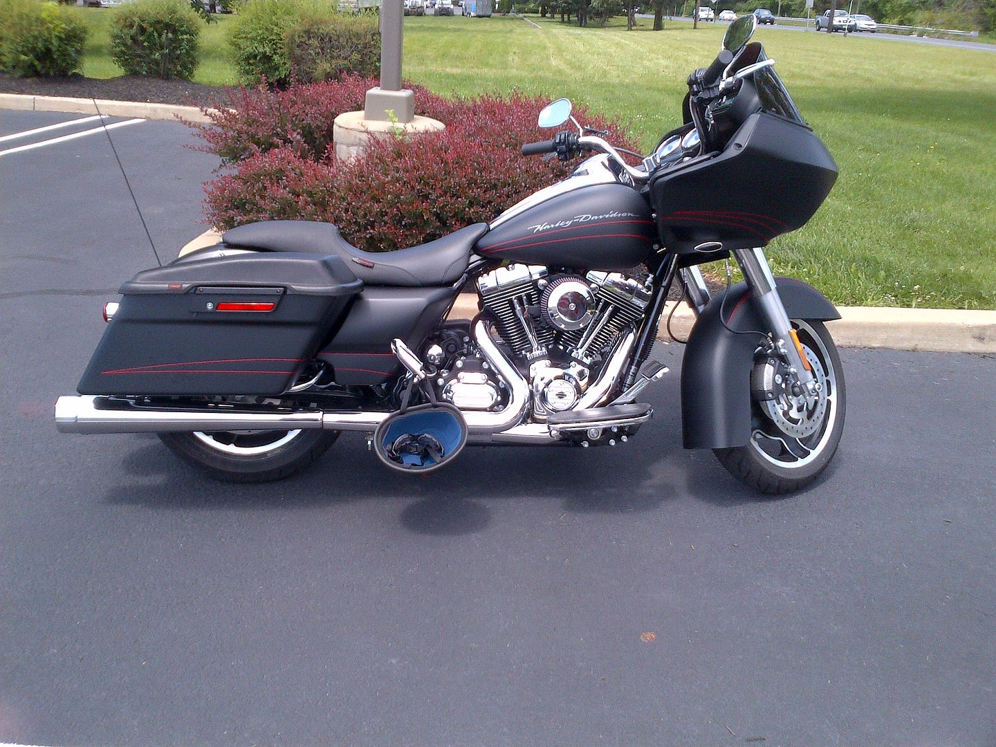

This is her a few weeks ago
And as of last night

Got a little done yesterday and today.
Set the rear tire, it was off center about 1/4". After a load of searching the interwebs, the MOCO will allow 5-15mm. I couldn't see ho it would be able to move to the right without milling the caliper mount. I never checked the stock wheel to see if it was offset the same.

Mounted the compressor for the rear shocks in the unused ABS tray, I had to cut a little to make it clear. I tried mounting vertical but it was hitting the side covers.
I mounted the manifold behind the battery box. Only drawback is if i need to access the battery, ill need to loosen the bracket.

Fender and bags on. I'm putting in some 8" plasma rods until i decide what tail lights i want to go with. Also, I'm looking to see if i can purchase or have a pair of CNC'd tips made. I love the ones from Nasi but he doesn't sell just the tips. The guy i spoke to told me they have 2 different CFR's one for their bags and one for most aftermarket. If all else fils, ill sell the ones i have and order a set from them.
