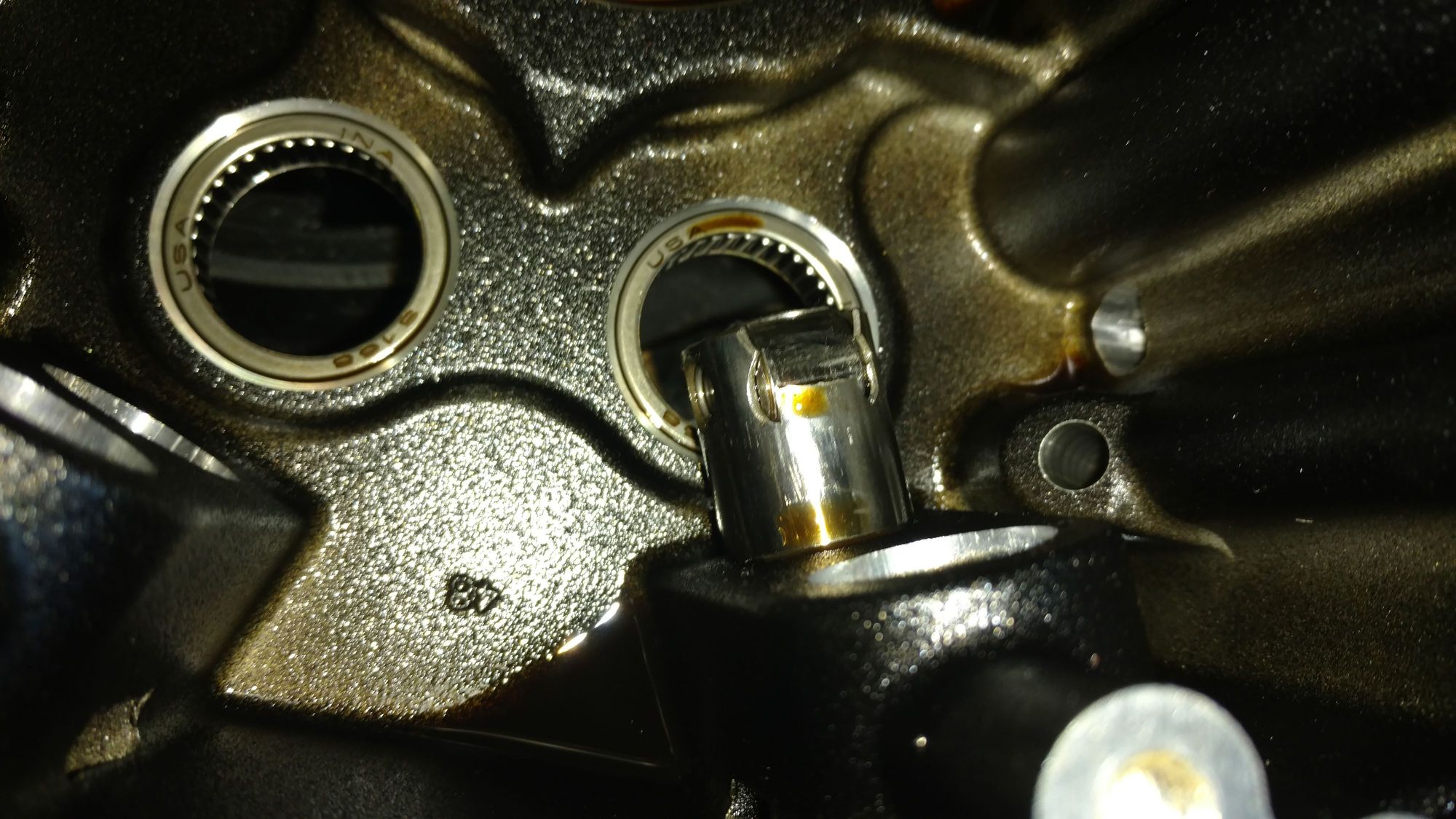

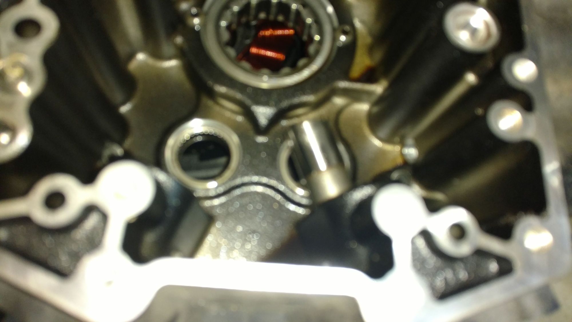

Rear intake lifter got jammed in the case and started tearing things apart.
It was hammering on the cam lobe so hard that it broke part of the lifter near the roller.

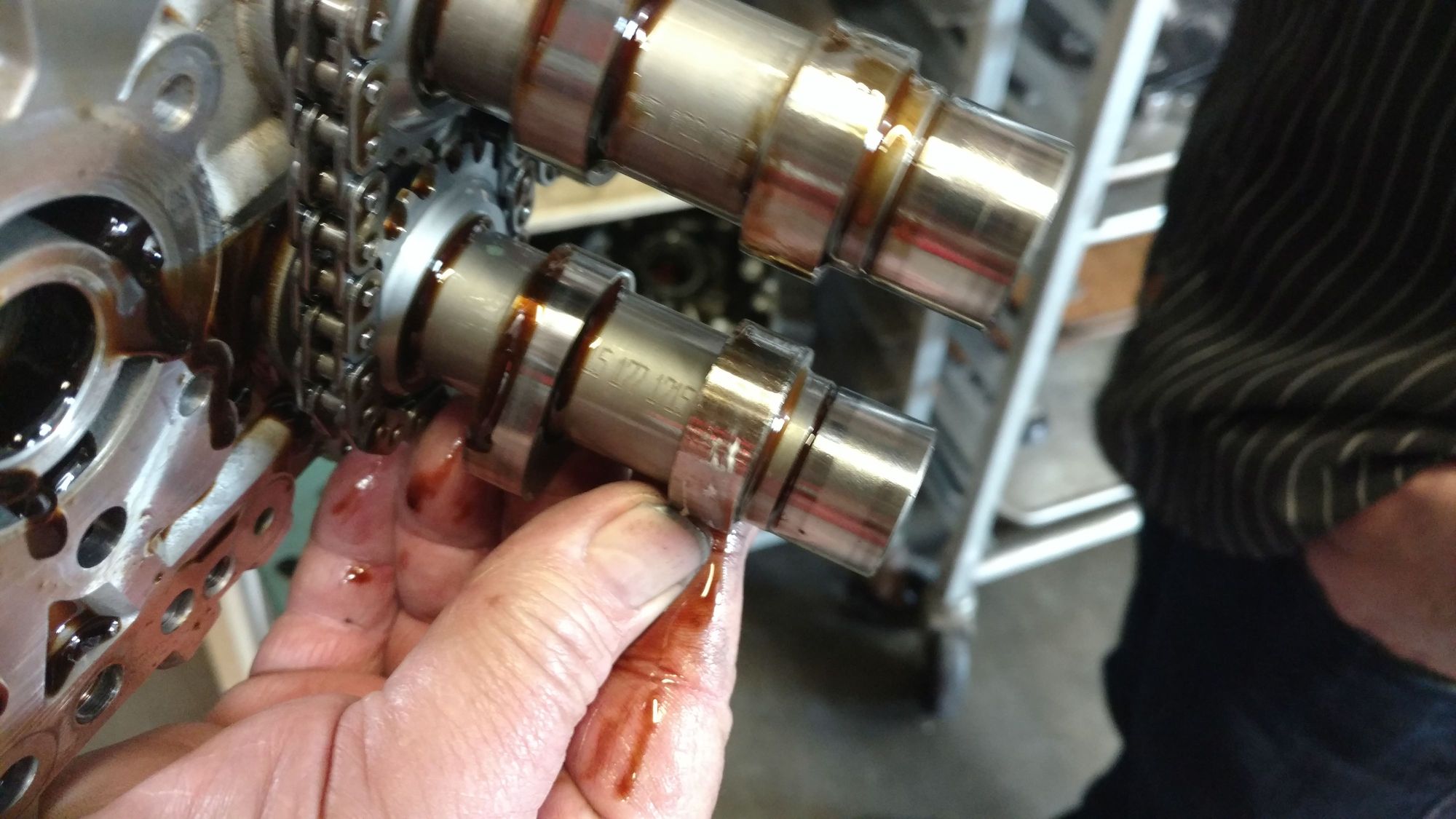

Here's what the cam lobe looked like.

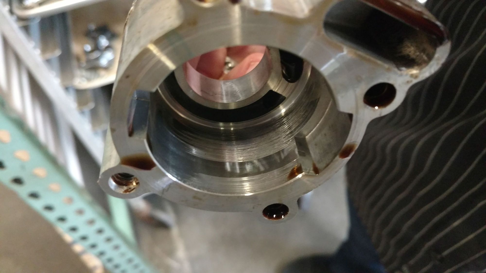

That sent metal throughout the engine. Here's the inside of the oil pump.

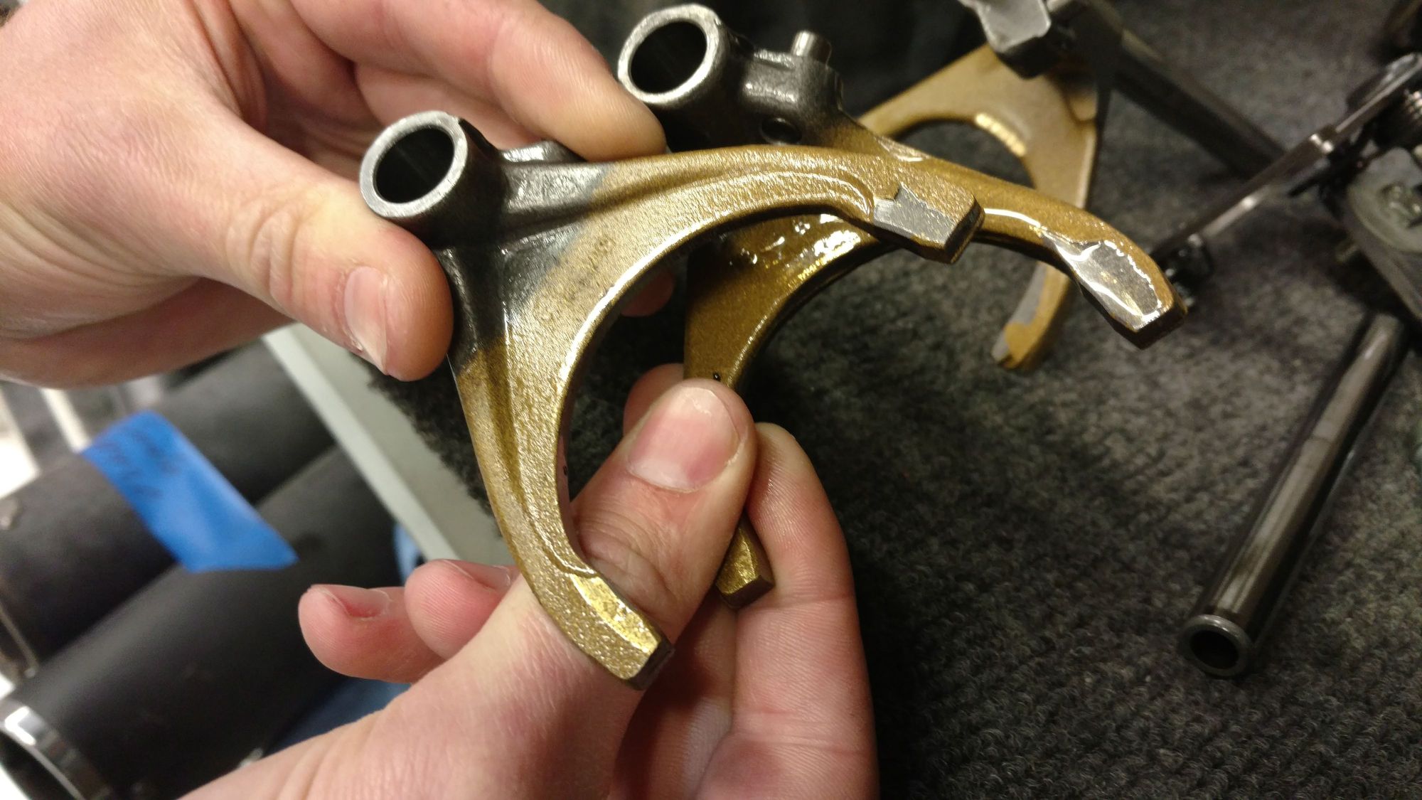

While the tech was in this far, they checked the transmission. The shift shaft was loose in the bushing. At least the gears were good, but the shift forks were badly worn, so they are going to be rebuilding the transmission while they have the bike.

They opened the tranny because the shift shaft was loose in the bushing and leaking. They wanted to make sure there were no deeper issues.
