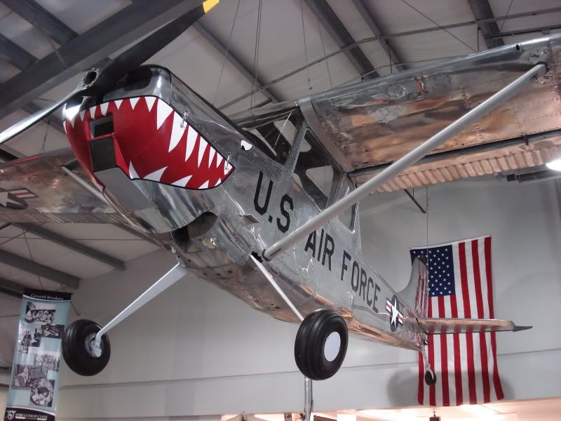

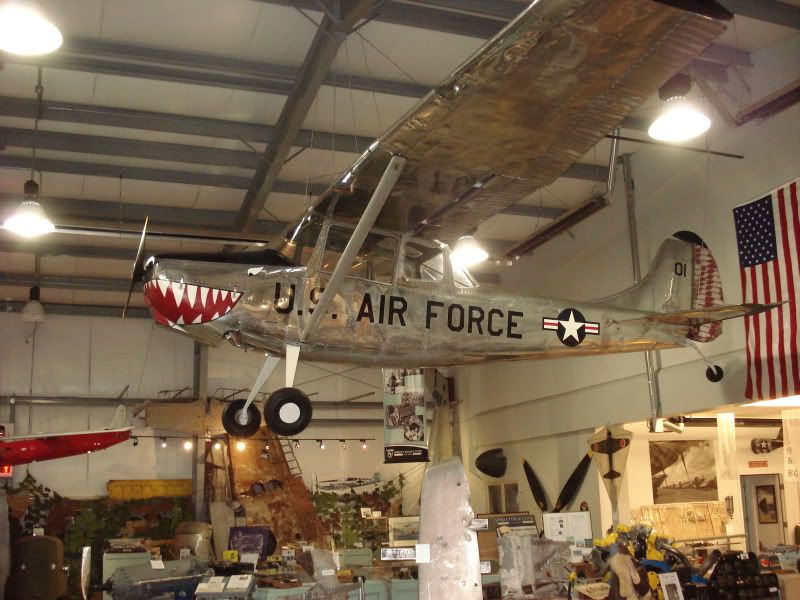

#18 · (Edited)
DC, Predator and Grey Eagle UAV's. When opportunities arise i will pick up side projects too. Last one I re-skinned sections of the wings on a Mooney. Biggest side project was helping in restoring the prototype Cessna L-19 Bird Dog as a static display.
On display at the Spirit of Flight Museum in Erie, CO
Before restoration. In the picture was its final resting spot after it broke free from its tie downs in a wind storm and took an unmanned flight. Damage to both wing tips and Horizontal stab. Dented the tail section pretty good where it landed on the wall.
#19 · (Edited)
You re-skinned a Mooney??? That's some project! Why would a Mooney need re-skinning? My ex-brother-in-law had an older one...nice plane, I got to fly it a few times...never got to do much maintenance on it...helped him do a tune-up while he was getting an annual done.
That's pretty cool working with drones!
Gotta edit....it's late and I thought you re-skinned the whole plane! LOL!!! Beautiful L-19!!! I had to push one of those around a hangar for a while.....the owner was a Bird Dog pilot in Korea and had bought a Med-e-vac one in original condition, but he wasn't working on it...it was just taking up space in my bosses hangar....HEAVY sucker for a "Light" aircraft!!!
