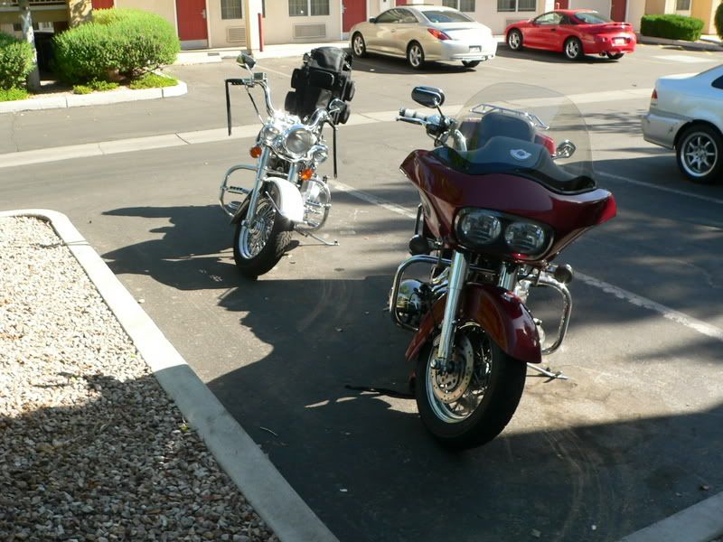

93 heritage
pics of me installing a 50 states legal exhaust to get out of trouble with the Cailfornia popo

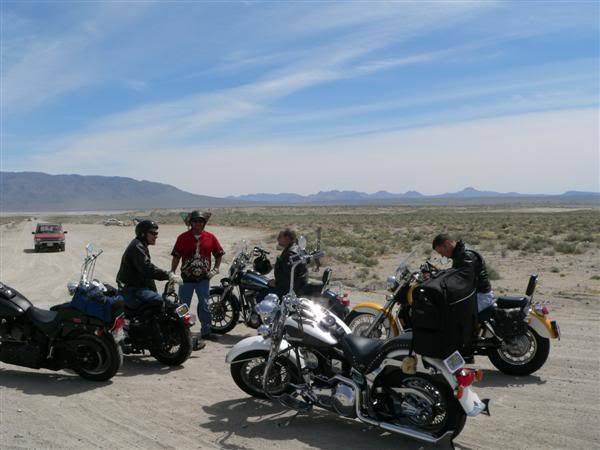

a bunch of us yay-hoo's hanging out in death valley, 2005, right after I had my motor done and was running Samsons
notice the t-bag, still have it and it's still in really good shape,
saddleman seat which stayed on the bike for all of 2 month, scratching the piss out of my fender
left to right:
john: 74 shovel
brian: (bright red shirt) 05 night train
capt: 03 low rider
clint: honda, tagalong military guy
donut: 93 heritage (again)
then vegas bike week 2006, red rock was amazing
this is thunder bolt colt's 2006 road glide

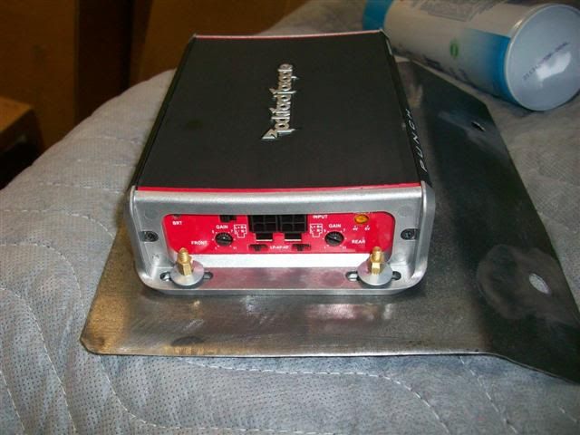

preliminary mock up of a yaffee style diy mount
stock used, leftover stainless satellite dish, big hammer, drill and grinder
wanted to place the 6 3/4" openings so that if I did decided to use larger
speakers later I would have less to cut, tried to visualize squeezing in the
neodymium magnet from the MM series
this is about as far as I got before the whole thing started cooking and popped, amp okay, hku had to be replaced.

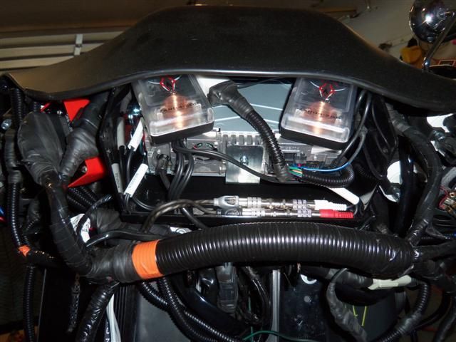

4
the only thing I've changed since these pics is re-routing the power and ground wires up and away from the head light area
still rocking 400w d-i-y style - will add another 2-4 speakers + another 400w once I have a chance to listen to various systems over the summer

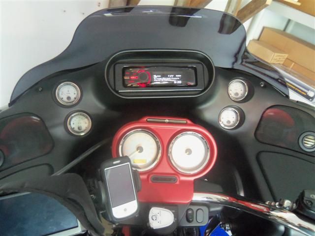

this is how my stereo turned out, real happy overall, I have a sidecar cycles splash guard on the way
for wiring, ended up going with a 14 gauge wire, then buying 16-22 fitting, tin plated copper,
work out pretty good, once stripped the wire barely fits,
you can then accurately crimp, place a dot of solder, heat shrink that puppy up,
make a real professional connector
these haven't been soldered or shrink wrapped yet.

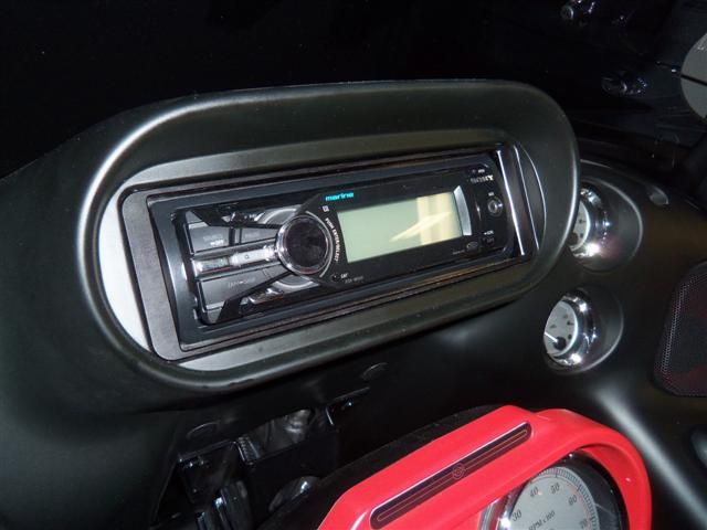

update: my marine head unit only last about 3 weeks in the elements before shutting down, FM died, AUX in died, inside usb worked up until the end
this is due to a couple factors, 1. running without a rain cover 2. more than likely getting the hand controls wet with the pressure washer mist
replaced with the red faceplate DSX-310 and sidecar cycles splash cover this morning, does pandora, has song and album skip ahead, no more suffering through a whole album or forwarding through every song, way better radio, pandora stream great also
and looks cooler, these are tough pics to take, but it is visually appealing
also noticed some areas where speakers are rubbing causing the fairing to distort slightly, just left it, didn't bother me enough to repair at this time.

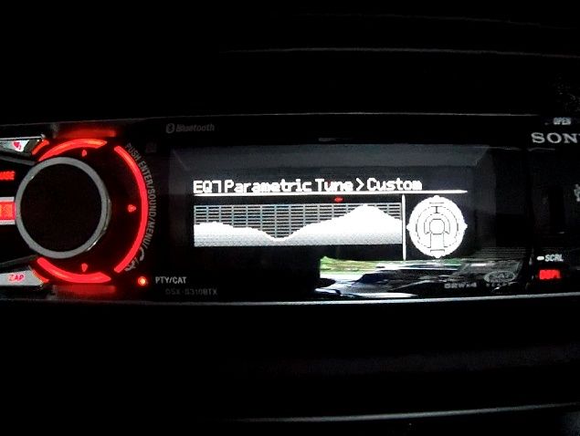

application notes: DSX-310 - 14 band parametric EQ, kind of a pita
when on the bike I only make volume or song changes, anything else, I pull off to the side and deal with it there.
no test ride yet, should sound about the same

Looks good Donut!
I can say two things,
a. yes, you can't see it in the sun
b. it's okay, because it's easy enough to toggle between radio, mp3, ipod or pandora
radio tuning on this is fast, that I like.
(( it took me a few week to set the EQ on the MS-60, this should be no different ))

h-donut, I like how you made those amp brackets.. I need a set of those!! Hint..Hint. Are you still able to use your handlebar controls to control the headunit?
controls work, but AVC is hard tied to speed sensor and interferes, so set
EQ before hand, or where I'm headed, maybe disable AVC altogether
I'll look into stamping out some brackets, would run about $25 shipped
if feasable, both sides for $45
here is the EQ I came up with so far, about 2 weeks of messing with it.
optimized for DM on LOUDNESS on, PBR300x2 about half gain, LP turned up just a hair

If you ever decide to make those amp mounts, I'll buy one. Yaffe won't even SELL you one unless you buy the amp from him SMH...
okay, well I got some aluminum stock and will doing some prototypes this weekend.
not rocket science or brain surgery, but if you are like me, you want it to fit and be as effort free as possible.
I'll post as soon as I have something to show.
