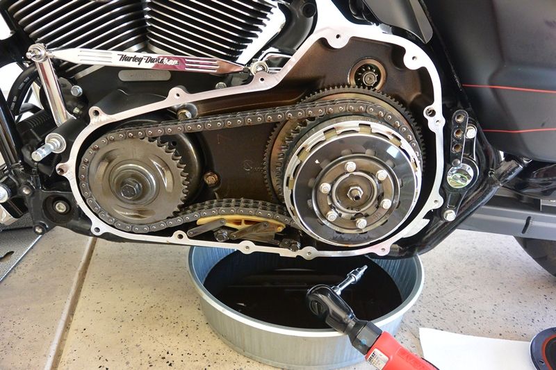

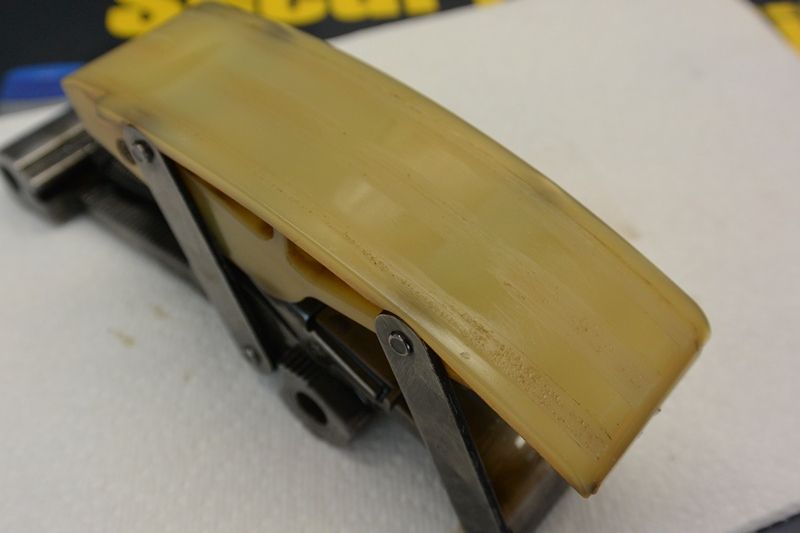

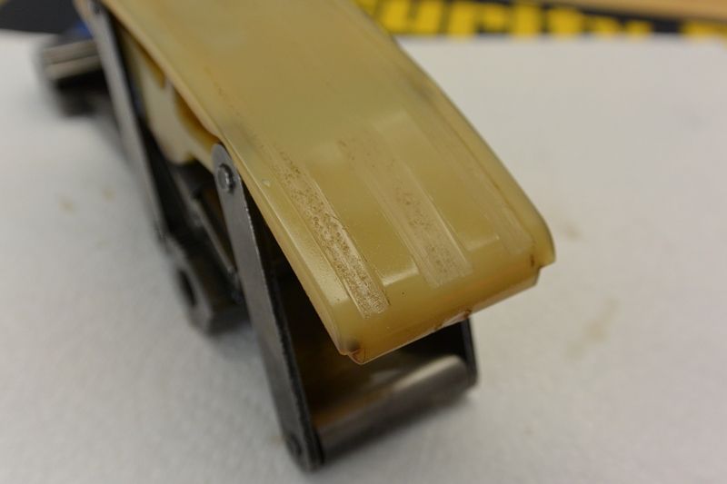

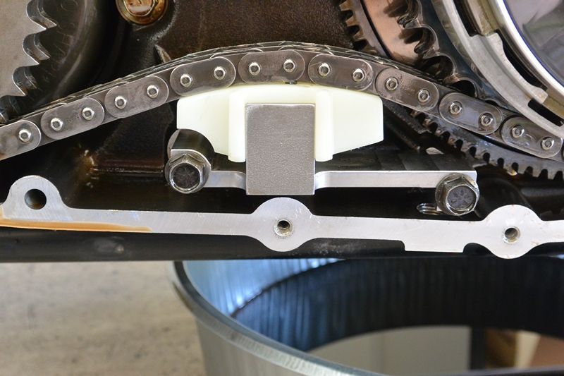

Ok, this is rather simple stuff. I took everthing off that needed to come off. Then installed the Hayden Tensioner. Some of you guys say "I had it done in about a half an hour" well, I took my time, about 1 1/2hrs. Just followed the directions and was very careful about the torque values. Here are some pics....
This last pic is for Hullhorr if he sees this post.

Got mine sitting on the work bench. Plan on doing the switch soon. Did you use any of the shims in the kit ? Are you planning on upgrading to the S.E. compensator also ?

Looking back at the pictures it looks like the chain was cutting into the stock tensioner a good bit. Looks like it was a good time to get it changed out.

Maiden voyage was good, just a short trip to the store. Tomorrow I'll get up to freeway speeds. Some people say they hear a "whirling sound" for the first 500mi. or so.......kinda, maby, I guess a little.

Looks like you shoulda got that out of there about 10k ago...

One quick question. In retrospect does anyone know or think I should have used Harley's blue locktite on the tensioner mounting bolts....just ask'n.

I haven't used any loctite on mine and they stayed tight. There is so much tension from the springs I don't think they will loosen up.
