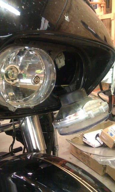

That's a fact, I have a 2011 (son too) we changed his bulbs to HID WITH OUT removing the faring. Simply remove the bezel and take the 4 screws per light out.

while you have the fairing apart save yourself the hassle and convert your headlight backplate. I did on my 09 and it is great. Someone had a full description on here but basicly I removed the headlights from the backing plate, remounted them to the front and backed out the adjuster screws to recess the whole package. I left the bubble off and went with the 09 CVO trim. very sweet and easy.
