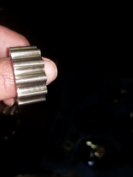

Pulled the oil pump apart the first set of gears that send the oil to the filter are clean and in great shape.
Now with that being said the second gear set or the scavenge gear had some very small impressions. Very hard to see but can feel them.

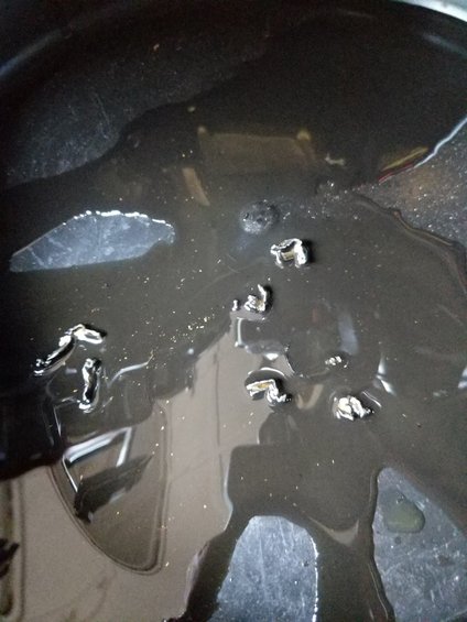

My next step is to check the oil filter and see if metal made it to the filter and then to check the runout on the crank. Other than that what should I look at besides these two things?
Next I plan to flush the engine to try to remove any left over metal. Any suggestions on what to use for a flush or technique or a procedure to insure success? I am thinking the the metal may have made it to the oil tank but not through the rest of the engine.

That whole motor needs to come apart. The oil filter is in bypass until the oil warms up, so it's not filtering during cold starts. And since that's not an instant failure, it was most likely started a few times after the oil was collecting trash. So that stuff could be all through the motor. No way you'll ever be able to get it flushed out, too much indirect oiling. And don't forget the oil pan, it'll need scrubbing out too.

Do you see the sparkle in that oil, that could be all through the motor. And its not bits of plastic, its steel shavings. The oil pan and Timken lefty would worry me the most. Cost for a tear down is a gasket set and a set of rings. Adds at most two days to the job if being done at home.
If you put it back with just a cam chest repair, then you get to spend the next 20K miles wonder if the noises you hear are related to the trash in the oil or just normal twin cam racket.

Here is a tip for you, an idea I use in the shop, take some of the oil put it on a paper towel, pop it in the microwave, if you see a light show you got metal in the oil, if not, it's probably minor amounts only in the filter and you should be good with a repair not a replacement.

1. compression test; this will tell you if you have damage from metal in oil. Good compression, your jugs and cylinders are good, and I would change out rings.
2. drop the oil pan and see if there is any metal in there. If no metal, your isolated on the damage even more, which is good.
3. needle bearings, I would split the case just to check the crank and positively ensure no metal.
