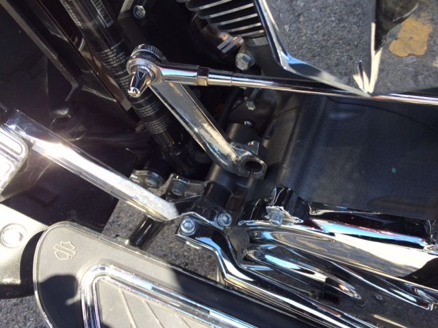

Like title says 2015 RGU CVO 8950 miles running 70 slowed down to pull into Murphysboro HD traveling home from the smokies, stuck in 6th gear. Service dept was great had to replace linkage, shaft and inner bolt and added some locatite too.......
There was another 15 CVO in with the same problem. service folks were worried they were out of parts.
Seems his is a common occurrence so check your entire shift linkage on the Rushmore bikes for lose bolts
It happens on the older models too. Gotta keep checking that bolt.
