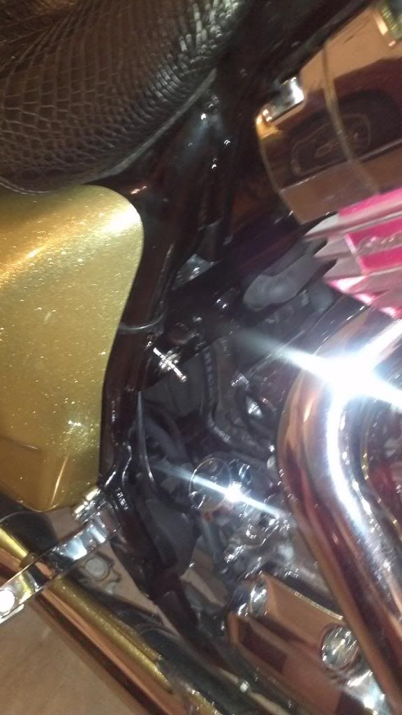

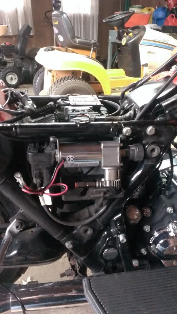

Well i finally got mine installed today. I wound up mounting the compressor under the right side cover and the solenoid right behind it to keep everything as close as possible. thats the test fit but it worked out perfectly so it stayed there. I used two large stainless hose clamps to secure it. I didnt have much time after i finished the job to check for leaks cuz i needed to go to work. I was however brave enough to take it to work though. Once i get it dialed in i think i will really like this set up. I do have to locate a small air leak too cuz it will drop after about an hour or so of sitting. Ill hopefully get to that sometime this week
