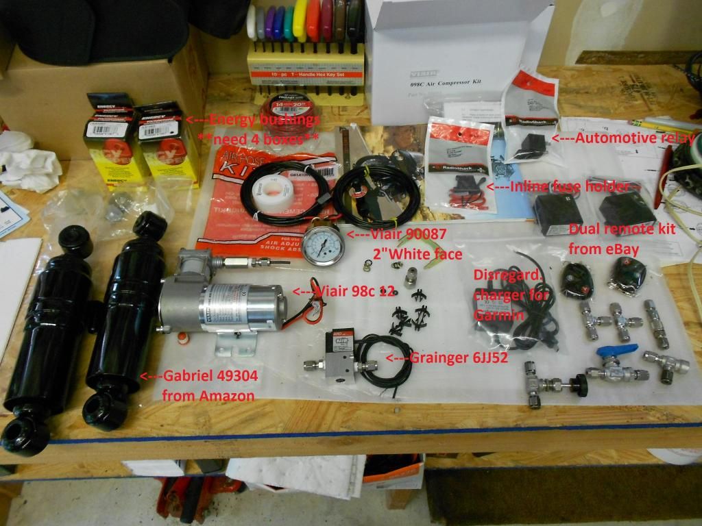

so in parts, you need gabriel or monroe shocks, air pump, solinoid, T block, relay, switch, release valve and pressure gauge, and bushings
if you go to amazon, they already have all these parts bundled as a customer who bought this bought this...

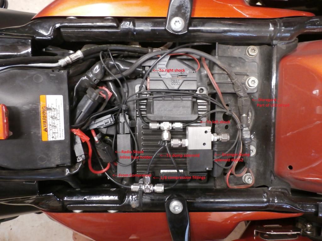

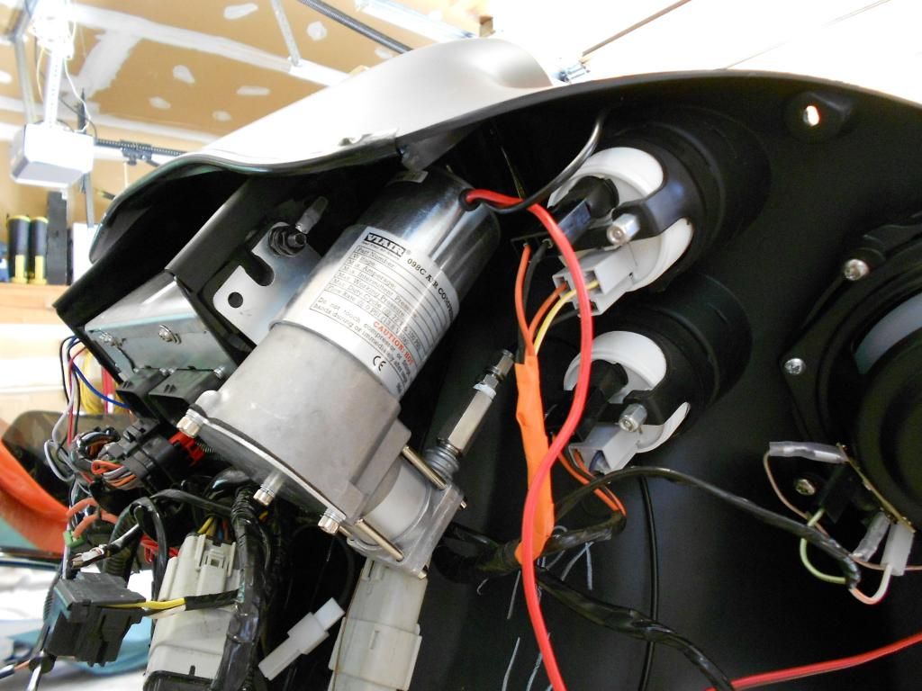

Here are a few pics of my set up Duncan......

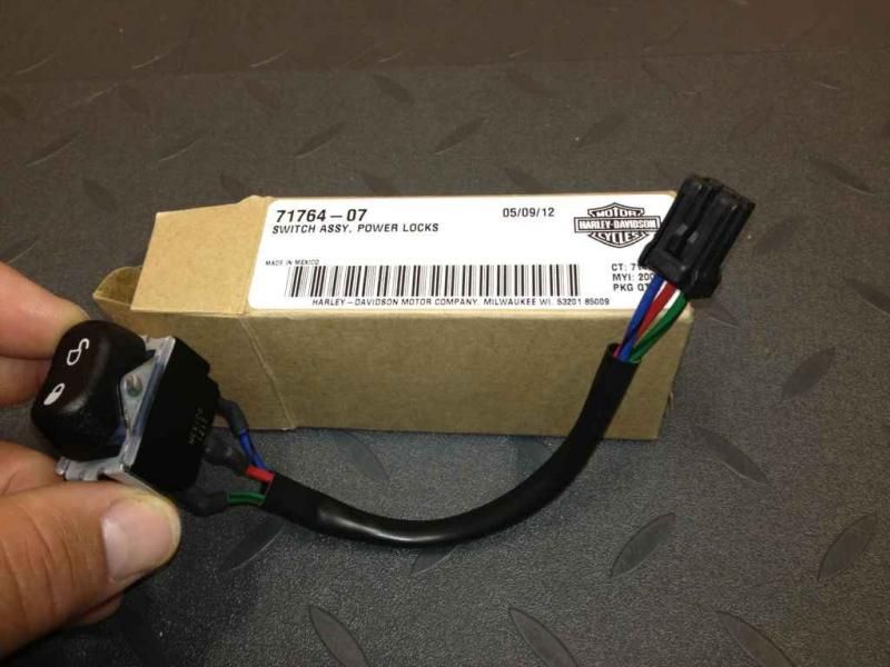

I also read of guys using a CVO switch, is it part number 71764- 07 switch assembley power locks? and is this the switch used for on/off of the pump?

All you need is one switch if you're running one pump.. If you use the CVO trunk lock switch you won't need a relay.. But if you use a rocker switch, depending on the switch power handling capacity, you may need to run a relay switch with it.
If you use the CVO switch you do need a relay. You have to turn the compressor on and activate the dump valve. At least that how I wired mine.
I thought the idea of the second switch a momentary type unit for the dump was so you could adjust down on the fly with a bit more control.
You dont actually need two switches. You can buy that HD switch that theyre talkin about which a 3 position momentary switch. Momentary on ,off, monentary on. I got a small aftermarket 3 way momentary toggle im going to use when i do this mod over the winter. Still got a few weeks of riding
I used the CVO trunk switch with no relay and it works great. No issues at all.
