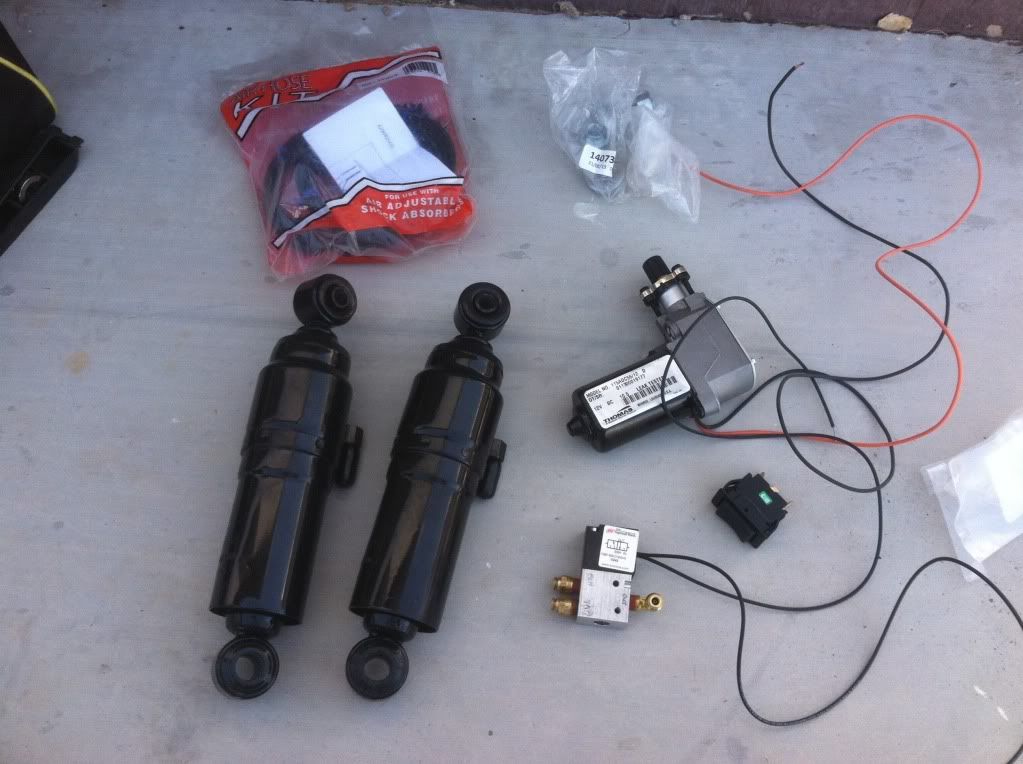

Started buying the pieces myself. Only have the solenoid. :eek:

Got all my parts and did the install before laughlin ... when I get home I'll shoot some pics of the switch location and my istall. I didn't like it much at first , the shocks were airing up way slow, so I loosened up the fittings going into the shocks and found out I had the lines pushed in too far ... FYI about 3/16" past your O-rings is all you need .... just put 600 miles on the new system on the river run and I LOVE THE RIDE !!!
