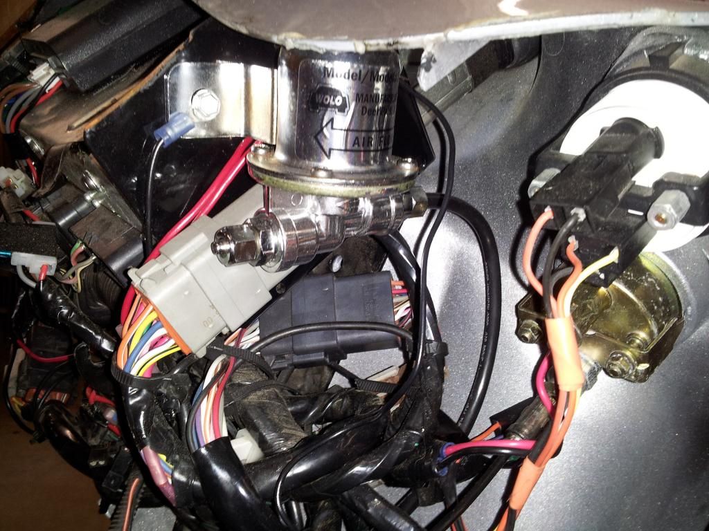

I ended up using line from the kit and yanking the stock. I'll be using 1/8 throughout the hole system, plus I've got a 25ft roll of airline coming. I went ahead and mounted the compressor behind the saddlebag on the rail.

Thanks! I'm tryin to keep it all together close. I'm gonna tee off the line probably under the seat and go straight to a gauge in the fairing. Other than that, just a few wires that go to the switch will be going under the tank.

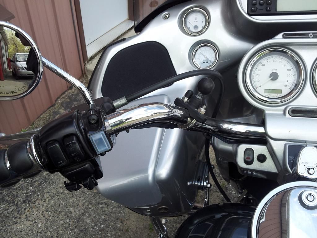

im using a momentary switch instead of on/off/on, arnott makes one that bolts to the lower bolt hole of the clutch bracket and you can get it cheaper from custom dynamatics #21-2610-B. I had to use this one because i have heated grips and the switch is on that side.
