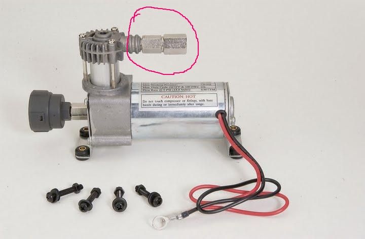

If you purchased a viair compressor most of them have the check valve already installed ... This will look like a little barrel nut ... It allows compressed air to travel to the shocks but not back into the compressor. without one the air pressure in the system would all be on the piston in the compressor and would leak and possibly damage the piston.. When you ordered your compressor it should have stated if it had the check vavle
the fitting right above the the label and threaded into the cylinder is the check valve
