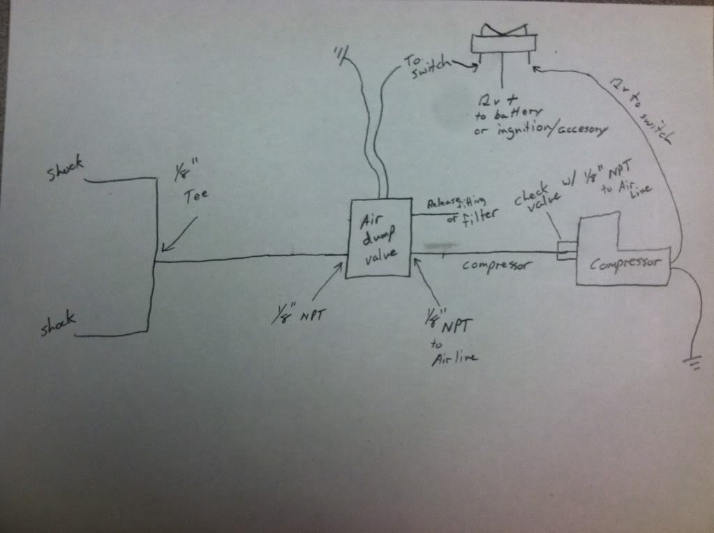

hope this helps ... i'm not the greatest artist ,
your dump valve is fitting specific i.e. an in and an out that should be marked, wich one did you buy?
P.S. I did not wire a relay switch in mine because It's only on for a few seconds therefore the relay in my opinion isn't necessary
im putting the dump valve in the line that goes from pump to shocks. im putting mine in r/h side cover, gonna run the exhaust out the back so when I dump it air shoots out back. :)
whats the check valve at compressor?
