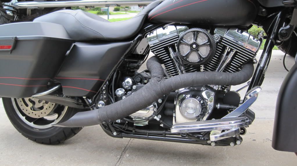

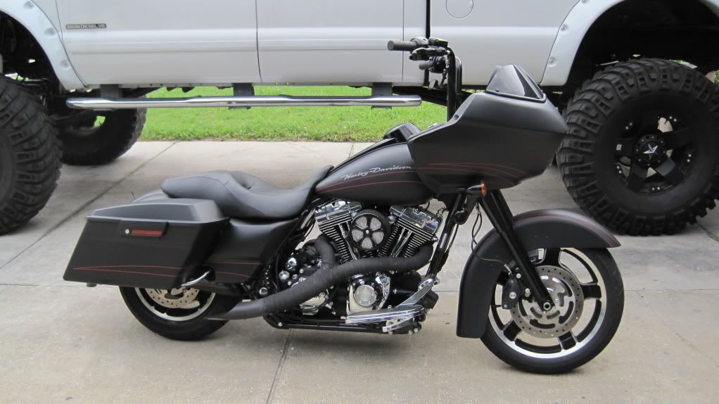

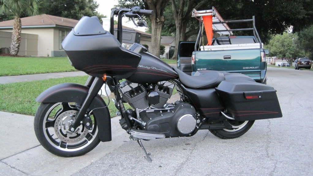

Not big on showing off, but figured I enjoy looking at everyone else's ride so here is mine.

Hey slowglide what bars are those
They are 14" Santee's
$99.99 out of custom chrome.
No need to extend anything other than the internal wiring.
Ya just becuase a part doesnt say compatible with a 2010 RoadGlide, doesnt mean it wont fit on your bike. The pipe is for a soft tail, and the bars are obviously narrow for a bagger but i like them.

Both nice lookin rides... Those pipes have to be LOUD AS HELL, but cool... lol. ;-)
It was loud when i got it, considering it is not offered with a baffle. I made one myself and have been drilling holes and tuning it to my preference. I have it about as loud as i want it and ive been able to tune it where the power is fair through out that power band. Main problem was the collector was getting realy hot took a lot of guessing and different baffle designs to make it work.
Sweet Bike, Sweet Truck!
Why a Range Rover?????
What can I say? My dad has good taste. Range is my dad's fiance's. Truck is mine.
In the Range's defense, I could never come out of pocket for one, but that thing is sweet.
