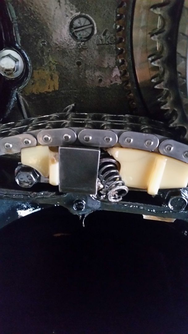

Well riding home from work lastnight my bike aquired one hell of a rattling/knocking noise. I get home from work about 12:30/1 AM so I didn't get into it until just now. I put it up on my trusty HF lift table and started the bike to see if I could pin point the noise. The noise was coming from the primary, thankfully not the motor. Pulled the primary cover off and was expecting to see something that exploded. I did. The Hayden tensioner shoe split in two and both of the springs were literally dangling there. FORTUNATELY there is no debris and the springs didn't whip around inside causing any damage. Now Im going to contact Hayden and see what up and if there's anything they will do for a replacement tensioner. [URL=http://s1073.photobucket.com/user/rlaf75/media/20151022_095058_zpswduwslay.jpg.html][/URL]

The shoe has groove marks in it but pretty much on the front edge. It split right around the center of the shoe. I just read somewhere that apparently Hayden has "updated" springs that aren't as strong if you will. I got call into Hayden along with an email to find out what can/will be done. I'm just glad there isn't any further damage

I just got off the phone with a woman from Hayden. She wants to talk to someone there before she does anything but she did say that they changed to a slightly lighter spring for less tension on the chain. She initially told me that she will send me a the new spring and a new shoe but still wanted to confirm it with her boss I guess. She's supposed to be getting back to me sometime later or tomorrow

As I said previously, Hayden now uses a lighter spring which I read somewhere awhile ago but Hayden confirmed it today. The lady told me that because I have one of the original tensioners but not that the spring caused the shoe to crack that she would send me a new shoe and spring

Spoke to Hayden today. They are sending me a replacement. My original email to them I attached the same pic that I did here. Having seen that pic they want me to send the broken one back to them. The lady said their R&D dept wants to "investigate" and see how/why mine came apart.
