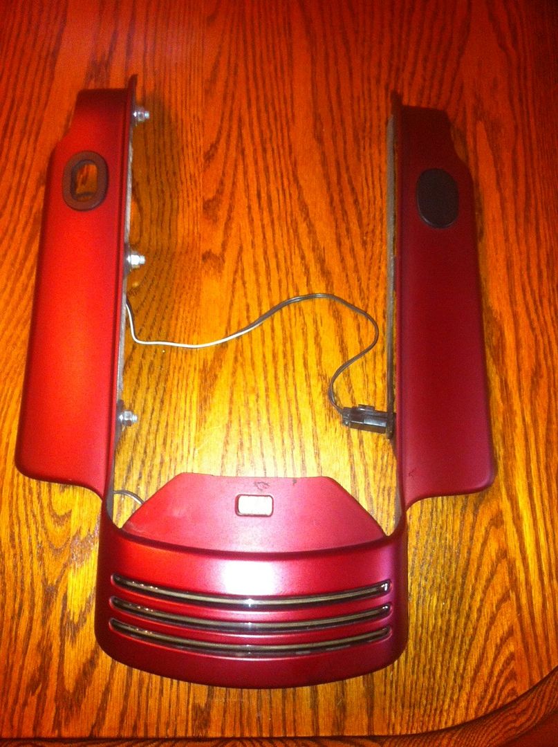

I love the rear fender on the new models of the RG. My 2007 needs one. Would a newer model rear fender fit or is there an aftermarket piece that would fit?
7,018 Posts
You would need a Street Glide rear fender 08 or older. The frame and rear wheel width changed in 09 so I am fairly certain the newer ones will not fit. You don't need the whole fender though just the fascia piece unless your trying to ditch the taillight. You can usually find them used on ebay. Just make sure the one you get is for 08 and older.

No just get one for a 2007 SG and it goes right on this was my 2007 with one on it.
Take the offer on the 2008 one it will fit. and is a steal of a price.

Fascia and tri-bar light, couple of plugs for the antenna holes and some 3-M trim tape to stick it to the fender are what some people have used. You can find the part #s here
http://partsfinder.onlinemicrofiche...l.asp?Type=13&make=hdmc&a=634&b=41&c=0&d=2007 FLHX STREET GLIDE® (KB) FENDER - REAR W/ SUPPORTS

I have the Fascia and Tri-Bar Light from a 2008 if you are interested.
$75.00 shipped to your door.
Send a PM if you are interested.

When you go to install it check and check again before you drill the holes.
PUT SOMETHING between your fender and tire before you drill or you may have to buy a tire.
Some have been know to install it with double side tape , if you do use really good stuff.

Thanks, I think I'm going to go with the automotive 3M tape that is normally used for badges on vehicles. I don't feel comfortable drilling into my fender.

Does anyone have the part number for the rear fascia? I ended up ordering one from eBay, but it ended up being way better than my 2007 RG.
