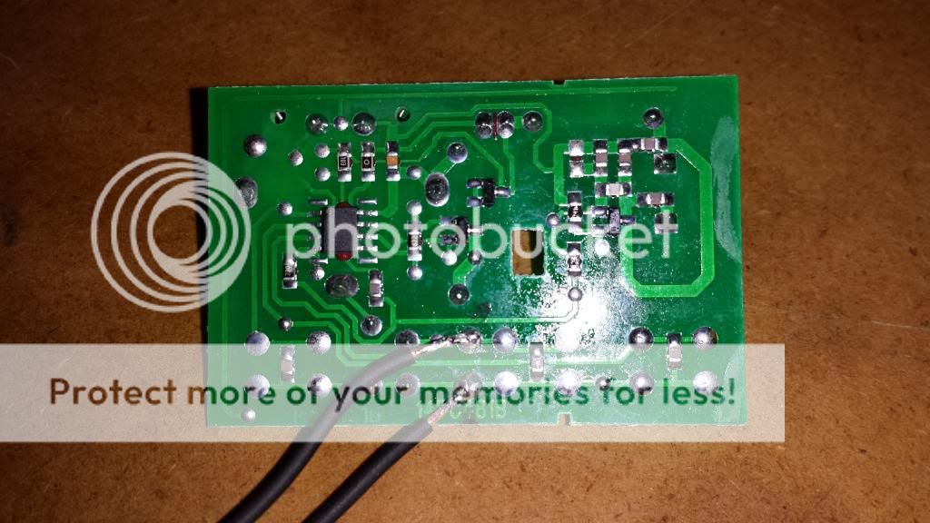

So being that my truck is programmed to open my garage door, I opened up my Craftsman opener and soldered a $13 Harley momentary switch to the mother board. It's the same switch that's used to change functions on the odometer
A simple 3/8" hole between the speedo and tach and presto, a $13 remote garage door opener! Yeah I know, I didn't get the hole centered, trust me, that's not like me, damnit.

Nice idea. Where did you mount the mother board at??
I just put the remote back together and fit it inside the speedo housing.

Discussion Starter #20
If you've ever soldered before you can do it. I just took a 65" piece of wire, bared both ends and started "connecting" solder points where the button was, once I found them, I soldered the switch on, simple.
Wade
Looks good. I think I'm gonna do this to my bike. How difficult was the soldering?
