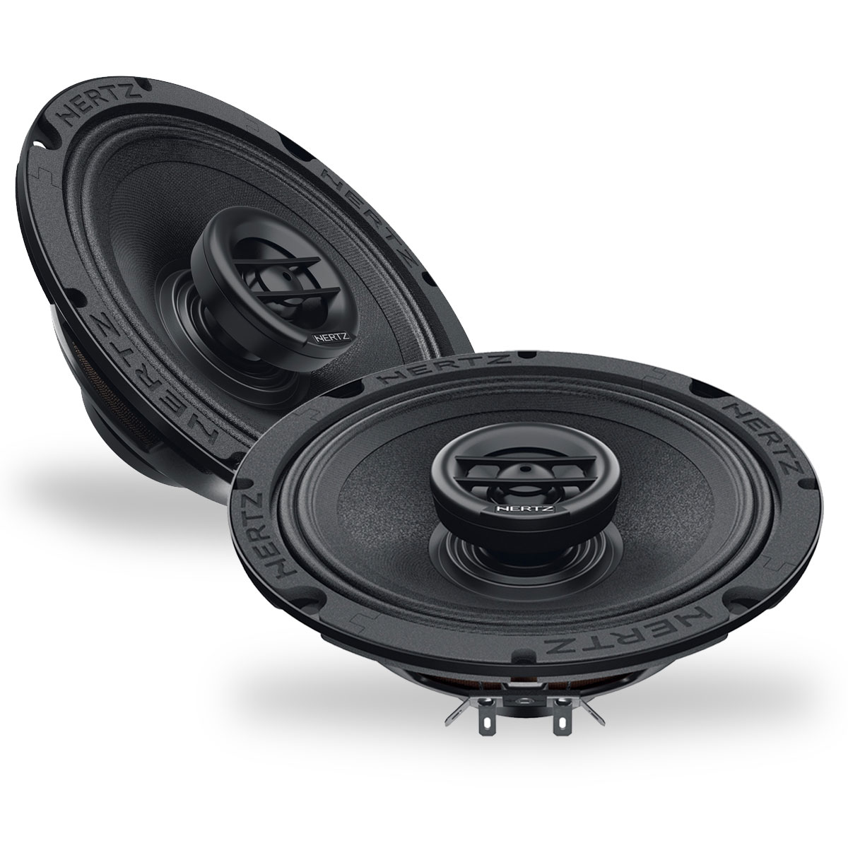

Hertz $450
  • 2-way car speakers (pair)
  • 6-1/2" pressed paper woofer with weather-resistant treatment
  • 1-7/16" PEI dome tweeter with resettable solid-state tweeter protection circuit
  • handles up to 100 watts RMS (200 watts peak power)
  • frequency range: 100-20,000 Hz
  • sensitivity: 96.5 dB
  • top-mount depth: 2-1/4"
  • cutout diameter: 5-11/16"
  • grilles not included
  • Sold in pairs
  • Weather proof

The 400.4 is a little light, even in a bridged configuration. 150x2 bridged at 4 ohm puts you in a spot where you are at max gain for the amp and min power for the GZ or Hertz.
As for the two speakers. Hertz makes a great speaker but I really think those are better in a tourpak because they’ll take a shit ton of power and play loud as hell with the right crossover. Probably set at 120-140 with 180w+
GZ will give you a little more punch on the bottom end and a bit warmer sound. Just my .02.
