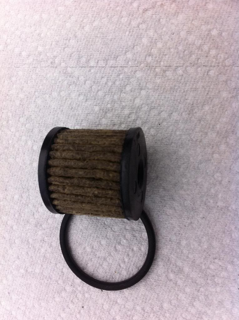

Here is a pic of my "Ethanol Enhanced Fuel Filter" with 29228 miles on her. I would definitely advise against waiting until 100,000 miles to change it like the Service Manual suggests. I can't imagine it doing a very good job if pushed to that kind of mileage.

Heres mine after 31,000 miles. You dont nee the tool. It beats of (huh huh) easily enough. I used the wooden end of a hammer. Whole job lasted about 30 minutes. Careful when taking the filter off. There was still pressure in there after starving the fuel. Ill bet thats why they recomend taking the lines off.
